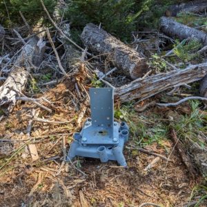

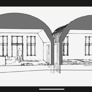

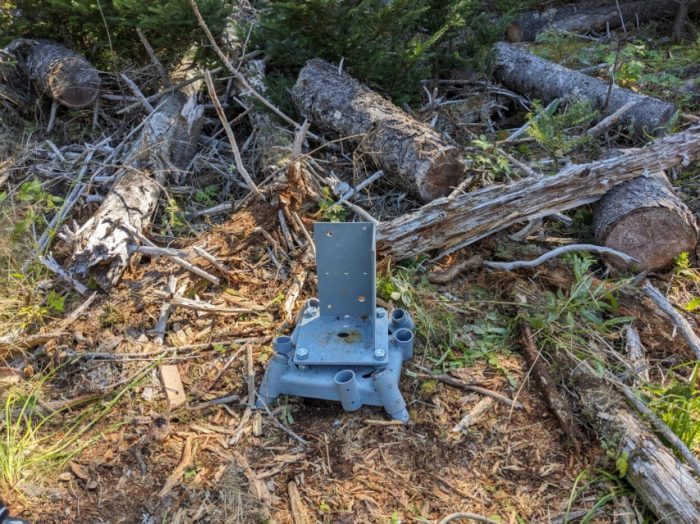

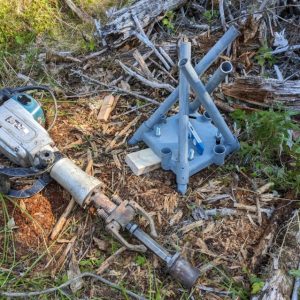

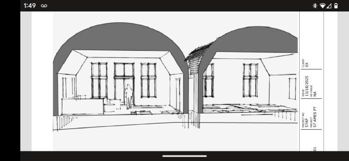

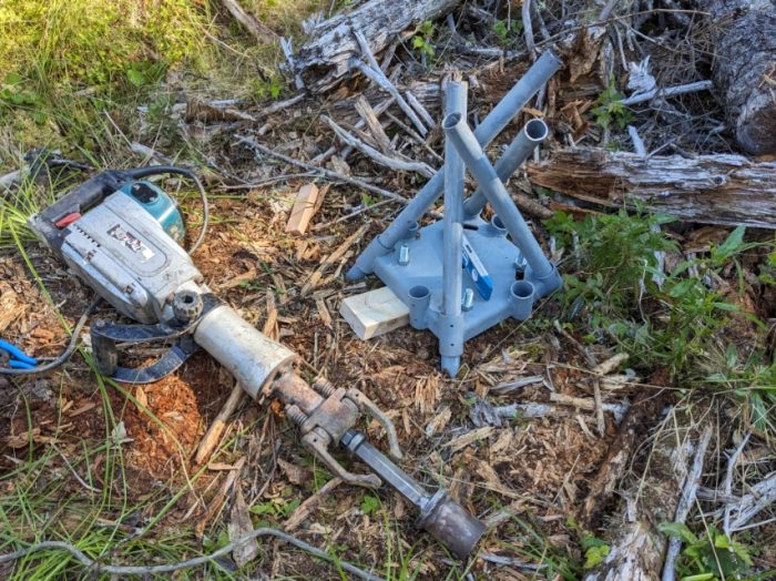

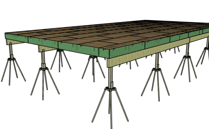

    I do some building on remote islands in Maine where there's no available concrete and extreme labor shortages. If the problems could be thought through and overcome, I like the idea of a structural roof and siding solution that could arrive on a flatbed. Pins as used on pin piers could likely anchor the Steelmaster base connectors. I've had good luck driving piers through the rocky Maine soil. Pic attached of a test pin pier I fabricated attached. They're incredibly secure. I tried to shift or pull this one out with a small tractor and couldn't move it.
    I wonder about a raised pin pier foundation with the quonset structure assembled over it, creating a vented crawl space below. A non structural frame could be built on the deck with dense packed insulation in the walls and blown in in the attic. Seems pretty straightforward except possibly detailing the air barrier at the floor to quonset structure. Maybe a taped cnc'd form out of ply? ... Gymnastics again.
    Food for thought.

      Both the Quonset huts I built came with instructions to embed the panels in concrete footings / stem-walls. I opted instead for a base-flashing they offered that conforms to the panels contours and can be bolted to either the thickened slab or wood frame construction. With the base condition dealt with, I don't see why y0ur plan wouldn't work.
      Insulating the walls and roof with cellulose seems tricky as the exterior skin is impermeable, so you get no outward drying unless you can establish a ventilation path - which needs to be open at the bottom and top.
      None of the difficulties I listed can't be overcome, and perhaps in circumstances like yours they would make sense. That's a different question from whether the house featured here is a useful prototype for widespread adoption.
