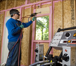

The Owens Corning EnergyComplete system consists of a low-toxic latex air seal and traditional batt or blown-in fiberglass insulation.

The primary purpose of this meeting was to introduce OC’s new insulation system, EnergyComplete, which consists of a spray-applied latex gasket/air seal combined with traditional batt or blown-in fiberglass insulation. While I have seen this product before—and from what I have seen, I am impressed with it—there were many people who were not familiar with it, nor were they fluent in building-science speak, which dominated much of the day.
OC’s biggest selling point is the low toxicity of the sealant, which can be applied without the need for complete personal protection and respirators; nor do other trades need to leave the house, as is the case with most spray foam products. I appreciate the low toxicity of the sealant, and if it and the insulation are both applied correctly, the system should result in a well-sealed and insulated building. But as with all products, the devil is in the details. Allowing various trades to be working in the house while the air sealing is under way could easily have people cutting holes in the building envelope after air sealing is done, creating leaks and thermal bypasses that get missed in the rush to get to drywall.

    Joe - To clarify, the sprayed on sealed is only used to provide an air barrier at connections between framing members and joints in sheathing. It still requires fiberglass batts, or preferably blown in batts to fill the framing cavities. Regarding the air quality, at least some, if not all of the OC fiberglass products are Greenguard certified regarding emissions from the in place product.

    I think this is a spray
    I think this is a spray applied latex caulk. It requires a spray equipment setup. Dont know if this is propriertary equipment.
    I would like to here more details about how it would be used. What are the different application techniques?
