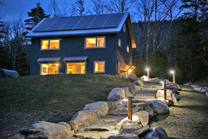

To reduce the catastrophic effects of global climate change, we need to make the transition from combustion appliances to electric appliances. If you have an all-electric house, you might want to install solar electric panels on your roof. [Photo courtesy of Green Building Advisor / Brian Post and Kyra Salancy]
There has been a gradual shift in emphasis for green builders over the last 15 years—away from focusing on thick insulation and triple-glazed windows toward an approach called “electrify everything.”
This isn’t just a fad.  The move to electrify everything—in other words, to phase out combustion appliances and, if possible, install a photovoltaic (PV) system—is based on sound environmental and financial principles. Whether we care about carbon emissions or energy saving, it can be hard to make thick insulation and triple-glazed windows pencil out. Installing electric appliances and PV systems usually makes better sense for the environment as well as our pocketbooks.

If your house has combustion appliances, you may be burning natural gas, propane, heating oil, kerosene, or firewood. Moreover, your car or truck is probably fueled by gasoline or diesel. All of these fuels release carbon dioxide when burned, and all can now be replaced by electricity. If you’re lucky, you may even be able to generate some or all of the electricity you need at home.
Of course, it’s important to remember the first rule of green living: “use less.” If you’re building a house, make it as small as possible. Try your best to live near public transportation. If you can get by without buying a car, that’s great. If you can manage with just one electric vehicle, it’s better to own an electric bicycle than an electric car.
