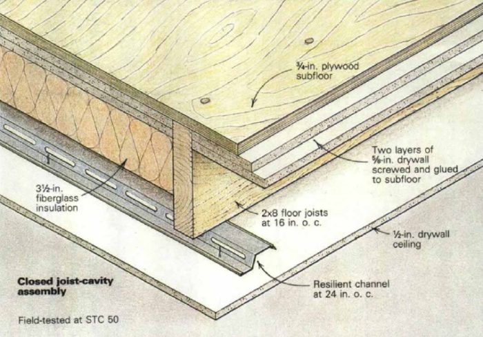

“I’m aware of using more than one layer of drywall,” he writes in Q&A post, “but is that the only way?”
Increase the mass of the wall
Car is reluctant to add a second layer of gypsum drywall mainly because it will, however slightly, reduce the usable space in the room.
But increased mass is part of an effective strategy for reducing sound transmission.
“Here are some good rules of thumb,” writes Robert Riversong. “When the mass of a barrier is doubled, the isolation quality (or STC rating) increases by approximately 5 dB, which is clearly noticeable. Installing insulation within a wall or floor/ceiling cavity will improve the STC rating by about 4 to 6 dB. An airspace of 1-1/2 in. will improve the STC by approximately 3 dB. An airspace of 3 in. will improve the STC by approximately 6 dB.”
A second layer of drywall, often 5/8 in. rather than 1/2 in. thick, along with resilient channel to isolate the drywall from the wall framing, increases mass and reduces sound transmission. Andy Ault, however, suggests three other options.
These are: Celotex SoundStop (a sound-proofing fiberboard), QuietRock by Serious Materials, and something called Soundproofing Mass Loaded Vinyl, manufactured by Super Soundproofing Co.
“We practically make this our [standard operating procedure] in walls between master baths and nurseries/adjoining bedrooms,” Ault writes of SoundStop. “We bond the SoundStop to the framing using an acoustical sealant running horizontal to the framing. Then we tape the joints with butyl tape. Next, we layer the gyp board over that in a vertical orientation. It’s quick, easy, and relatively…

RC1 channel in drawing
the RC1 channel is depicted inncorectly. It is upside down.

As someone said, it's not the components, it's the assembly.
Ref Mike's suggestion of silicone, I'd go w/ GreenGlue- it's specifically designed to remain viscous and to be a damping material, whereas silicone is designed as a sealant.. I haven't heard of using GG against studs, but that doesn't seem unreasonable. Definitely between first and second sheet of drywall.
Ref Cathy's question about GreenGlue, go for it- it may not cure your problem, but it's by far the simplest potential solution. I'd consider pulling your existiing outlet boxes and installing old-work boxes that only engage the second (damped) layer of drywall. (Or consider deleting the boxes in that wall.) If you want to get fancier, consider blowing cellulose into the stud cavities- the second layer of drywall will cover the holes. And if you really want to get fancy, install RC1 horizontally across the studs, then add another layer or two of drywall. Do check out the GreenGlue site concerning the potential two-cavity problem. They may advise against creating 2 cavities (studs, then RC1.)

Green Glue is different than an acoustical sealant, whose job is to eliminate holes in the barrier, "sound-sealing partitions at gaps, electrical box cutouts," "It dries to a tough but flexible film, forming a long-lasting, resilient, acoustical seal." (Quotes are from http://www.usg.com/sheetrock-acoustical-sealant.html ) If I remember my acoustics, a 10% hole can transmit 90% of the sound energy. (That's a simplistic generalization, of course.)
Green Glue, on the other hand, is a visco-elastic damping material which is applied to the surface of the second sheet of drywall, like Jackson Pollock or a kid putting syrup on a pancake. Then the sheet is slapped against the first layer and fastened w/ longer screws. It's a mildly messy process, although I've done it in a carpeted apartment- I only had to grab the mineral spirits a couple of times.. It's also available in a ready-made drywall/GG/drywall sandwich.
Imagine putting honey on yuor hands and trying to rub them together- your hands are the drywall, the honey is the GG. The sound waves flex the drywall sheets like a speaker cone and the GG is a shear interface- the sheets are trying to move relative to each other, the GG restrains them and absorbs the sound energy, converting it into heat, as you say. The added mass of the second sheet of drywall also helps w/ sound absorption- air is pretty light stuff and it has a hard time pushing something like drywall around.
Acoustic insulation sealants definitely help, but they don't disrupt "flanking paths," for example, studs, screws, outlet and light fixture holes and plumbing, which can transmit the sound energy directly from the receiver (the noisy side drywall) to the emitter (the quiet side drywall.) Think of the kid's "telephone," two Dixie cups w/ a string between their bottoms- the bottoms are the receiver and emitter, the string is the flanking path. Smear honey on the bottoms and it will damp the sound.

I have a finished basement room with (currently) an open, exposed joist ceiling. The main level flooring is 100+ year old hardwood directly applied to the joists. Needless to say, it's loud down there (not to mention the amount of debris that falls through the cracks). What about doing a "perfect wall" assembly on the underside of the joists? Call it the perfect ceiling.
Concept:
1. Air seal and add mass by applying the layers of drywall +Green Glue in the joist bays.
2. Attach 2' x 4' sheets of Comfortboard 80 to the underside of the joists, attaching with lags through 1x3 furring strips. The space between the drywall and Comfortboard provides the air gap.
3. Apply finished ceiling to the furring strips. Our plan was to use T&G Pine.
The Comfortboard w/furring strips would provide both functions of sound deadening and decoupling. Applying the Comfortboard to the studs would give the labor benefit of not having to cut to size and pack into the bays, which are a non-standard spacing in this old farmhouse.
Thoughts?
Back to the article - before investing all that time and money to work on the ceiling, make sure you take care of all the "flanking" noise paths.
Non-expert opinion: lag screws and furring strips won't decouple noise like "hat channel", e.g.,
