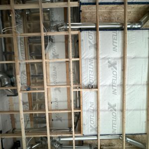

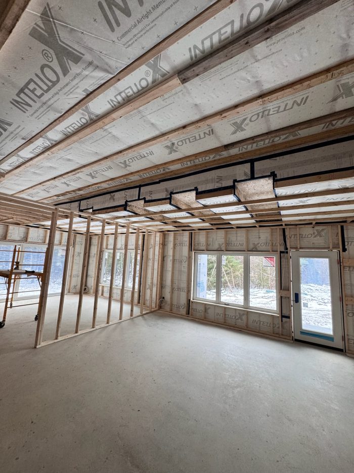

    RANDY WILLIAMS | | #8

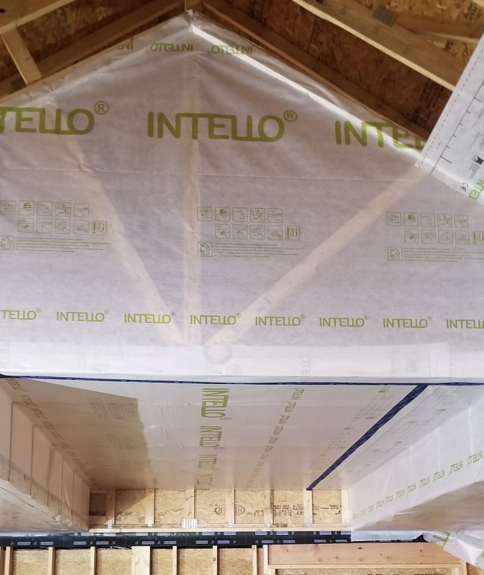

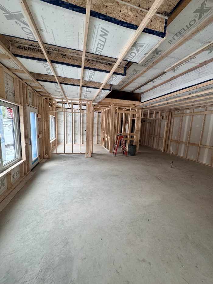

    What we've done is line the chase with a class II responsive (smart) vapor retarder (also acting as the air barrier), then install a plywood or OSB sheathing throughout the chase to protect the vapor retarder. The sheathing also gives the MEP installers a place to fasten anywhere inside the chase. Carpenter friendly with no drywall taping required.

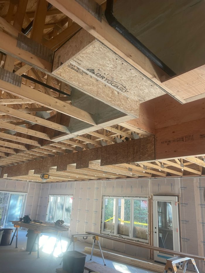

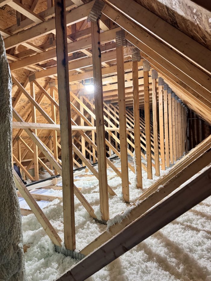

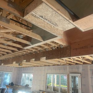

  5. sommerbros | | #17

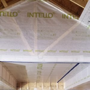

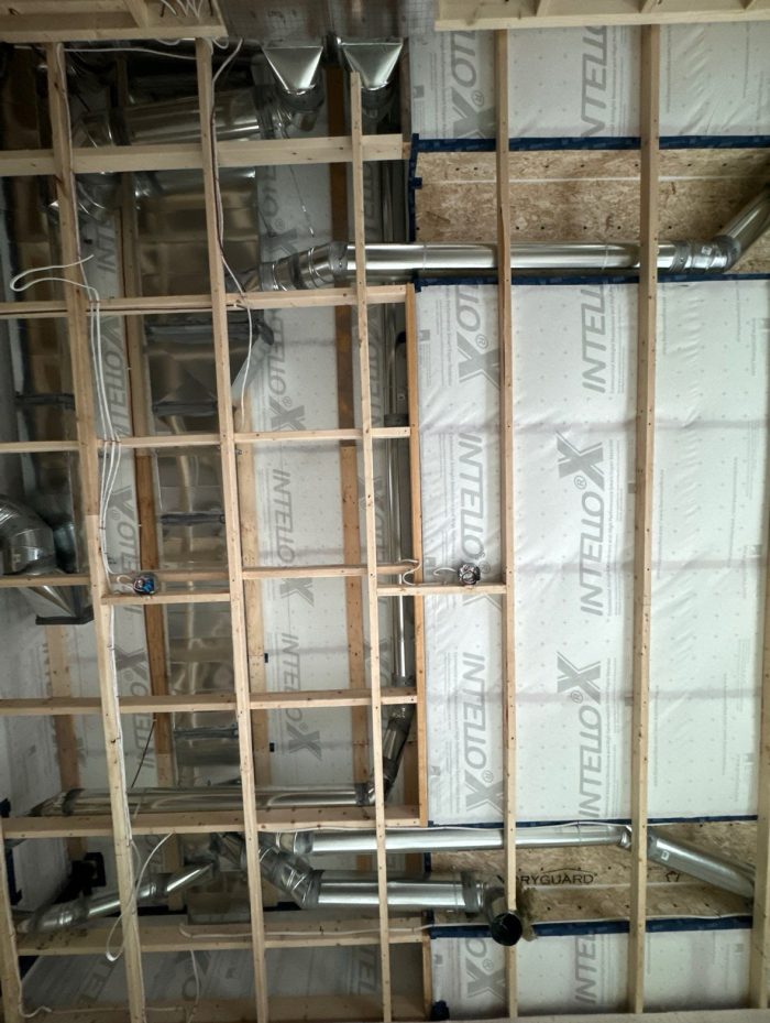

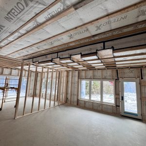

    Our approach is similar to Randy’s, using a robust smart air/vapour membrane to line the plenum bump in the truss. Running 2x4 straps perpendicular to the truss along the centre of the space allows for mechanical equipment attachment. Air sealed, three sided boxes made from 3/4” plywood or OSB create branch cavities are very easy to install between trusses and seal to the vertical sides of the plenum bump.
    We also slope our loose fill generously along the sides of the plenum bump, and with extended vent baffles at the eaves there is no issue with wind washing.
    Probably the nicest thing about this method that we have found, is that with an integrated service cavity at the ceiling, with the exception of through attic/roof plg venting and the odd electrical conduit which need to be roughed-in ahead of time, all of the air sealing and insulation work can be done prior to MEP.
