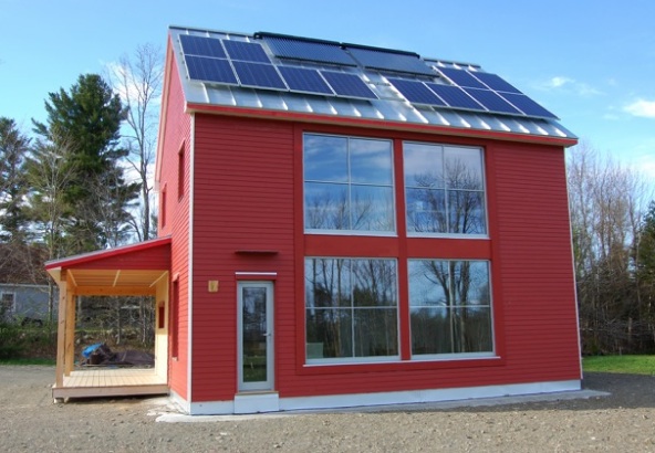

Maine's first certified Passivhaus was designed and built by G*O Logic of Belfast. What will it take to see this kind of energy-efficient building take root in the public's imagination?

    For starters most "PassivHaus" designs (such as the one pictured for the article) are down right ugly. Sure it's like my opinion man, but try asking the average person looking for a home in an average neighborhood and they'd tell you it's a non-starter. It doesn't fit in most neighborhoods.
    Yes I know it's all the rage and the trendy and the green types will understand but not me. I wouldn't have it. It's a non-functional design for me.

    Actually, the home pictured above has been receiving rave reviews by normal, average, non-GBA reading people for its looks, cost and performance. People really love it. So beauty is in the eye of the beholder. The firm responsible is GO Logic in Maine. Check out their other work
