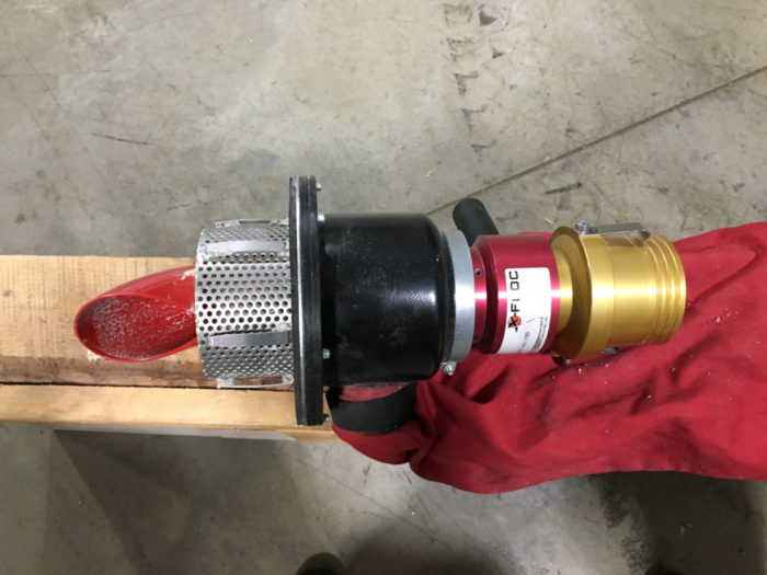

X-Floc, the company that developed this injection head for cellulose insulation, claims that the blowing equipment provides more consistent insulation density than other cellulose blowing systems. The head has a perforated collar connected to a cloth filtering bag.

At the end of my recent blog on Kooltherm rigid phenolic foam insulation, I mentioned that the roof and wall assemblies at an energy retrofit project in Brattleboro, Vermont, were insulated with cellulose by a company called American Installations. The company claimed that the German blowing equipment they use delivers cellulose at a more consistent density, and they were willing to prove it by doing a demonstration installation at their shop in Hadley, Massachusetts.
American Installations uses X-Floc equipment to install cellulose insulation. X-Floc is a manufacturer of insulation blowing equipment with headquarters in Renningen, Germany. The equipment manufacturer calls their approach the “X-Floc ventilated dry injection system.”
The X-Floc head (see the photo at above right) has a perforated collar connected to a cloth bag so that the air pressure driving the cellulose injection is relieved. (See Image #2, below.)
Wes Couture, one of three brothers who runs American Installations, describes their use of the X-Floc injection system: “The built-in passive ventilation for the cavity gives you the ability to handle the air that is being expelled from the cavity, and it provides a more uniform product.”
Couture continued, “The system is dustless. With a standard hose, there is no control to that air release and the air is basically being forced out the same hole that the hose is going into along with the cellulose; it is much more difficult to ensure consistent density on every cavity with this strategy. This system brings us to a single installation of the air barrier and dense pack [insulation] through the air barrier, and the cellulose is then also in direct contact with the air barrier as well. And because the air relief is built into the nozzle, we can install product significantly faster in certain situations, as we are able to increase the airflow much higher than if we were using a hose in a cavity with no air relief.”

  1. bencarsan | | #1
    Interesting but I have lots of questions
    The crudeness of American dense pack equipment is obvious and has probably frustrated installers like me for a long time. We make do with repurposed hose from other industries, poorly formed transitions between hose diameters, hose clamps for connections, big heavy loud machines that throw dust everywhere and aren't very portable even with wheels etc. And there's no pressure dump as on this German unit, so might have to wait 20 seconds after blowers stop in order to pull the hose out. Improved equipment would improve the process, but I am actually pretty satisfied with the outcome we get on inferior equipment.
    This demonstration leaves me with lots of questions. The videos don't look like the kind of dense packing I do. My understanding is that you only get reliable density a short distance from the tip of the hose, say 12-18" with a 1-1/4" and less with larger hoses which deliver a lower pressure/material ratio. So the process of dense packing typically involves a lot of "retubing"--pulling the hose out a short distance and then pushing it back in so that it you find and fill pockets of lower density material. When you get to proper density, the machine stops pushing material, and you move the hose until material starts flowing again. The X-Floc appears to have a nozzle not designed for attachment to a hose and it appears to be filling an entire cavity with no hose, but to what density? And the "conventional" video doesn't show any retubing, so I would expect uneven density there.
    Furthermore there may actually be a benefit to not having a pressure dump in retrofit situations, since the pressure will tend to drive material to leakage points in a stud bay, similar to the way that a product like "fix-a-flat" finds and fills a hole in a car tire.
    I look forward to learning more. Any idea about the price of the X-Floc equipment?

    Thanks for your comments. I haven't blown as much cellulose as you have, but I had a similar reaction to the demonstration. Clearly, if the company performing the demonstration wants to prove the superiority of the X-Floc equipment, they have no incentive to do a good job when using the "conventional" equipment (which is being used only to prove the superiority of X-Floc).
    I don't think the kind of voids shown in the video are typical of the work of an experienced dense-pack installer.

    You're right -- the design of the X-Floc head certainly resembles the design of the Krendl head (shown in the photo below).
    Krendl is an American company with headquarters in Delphos, Ohio.

    I appreciate the videos and article. I've been looking at the x-floc (its not cheap) and while I think it could prove useful with membranes in particular its a specialty tool not a panacea. It certianly works in PH construction using plywood as air barriers. Consistent large cavity installs with a rigid clampable surface for the rotary valve. The x-floc looks good here. They seem to have quite the variety of options including valves with tubes for probing.
    Pressure relief behind membranes makes sense too, (but we loose the clamping option) as Hulstrunk demonstrated with 475 as referenced, they don't vent well on their own when installing.
    The best part of these valves may be dust maintenance if they seal well to the wall.
    The "traditional" tubing demonstrated was as mentioned, not ideal for sure I believe better results can occur. In the end its air flow or fluid dynamics. if the rotary valve is 3" to 2.5" and the wall tube is 3" down in stages to 1.5" the rotary valve will fill much faster.
    Use the largest wall tube that will fit, set machines to dense pack verifying with a density box, do it properly and i'm not sure the rotary method wins.
