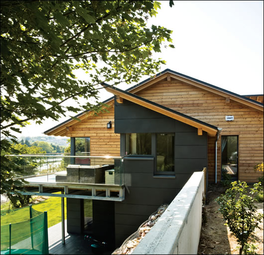

A Passivhaus home in Ireland. A striking new house in County Cork proves that meeting the passive house standard needn’t mean sacrificing good design, while the dwelling also boasts an innovative infrared heating system, green materials, plus a unique approach to using climate data in low energy construction.

Sally O’Leary says that when a site became available near the site of an old family home, she couldn’t pass up the opportunity to buy it. She’d been looking for a site to build on with her husband John. “We always wanted energy efficiency, I think nowadays that’s something that people have to do,” she says.
The spent a few years trying to get planning permission before turning to Cork-based Wain Morehead Architects. For Sally, it was important their design showed respect for their site — an awkward, sloping patch of land overlooking a local river.
Energy efficiency was important to the O’Learys, but architect John Morehead suggested taking things further and aiming for the more onerous passive house standard. “Passive was a complete dream,” Sally says.
Building envelope
The couple wanted a timber frame house, but as the design envisaged the house partially nestling into the ground, using timber wasn’t structurally feasible for the lower floor. John Morehead originally planned to use concrete block with external insulation here, but contractor Twomey Construction suggested going with insulated concrete formwork (ICF) instead.

He attributes the struggle to get to the passive airtightness standard to the complex shape and articulation of the house. A large folding wall on the first floor divides the main living space from the porch outside. “Quite a substantial area of the accommodation can be opened up to the elements outside the heating season, taking account of the fact that the principal accommodation is located on the upper floor level. The deep roof overhangs and balcony actively prevent overheating in summer,” he says.
The design of the house was “heavily influenced by the fact we were on a water frontage”, he adds — for a start, the living spaces are upstairs while bedrooms are downstairs. “We wanted to maximize the views down to the river and facilitate and encourage family activity, inside and out, on the upper level.”
