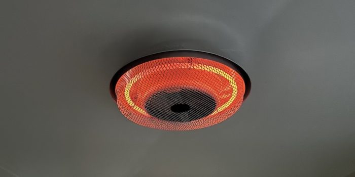

I’ve been making a statement for a long time that sometimes gets called out as inaccurate. The story began in the second month of this blog back in April 2010 when I wrote an article titled When Is 100% Efficient Not Good Enough? I’ve been claiming that when you turn electricity into heat (think toaster), the energy conversion is 100 percent efficient. But is it really?

The reason talking about the efficiency of strip heat and heat pumps drives some people crazy is that it’s the wrong quantity. We really need to talk about coefficient of performance (COP), which is defined as the ratio of the amount of useful heating provided to the amount of energy used to provide that heat. So technically, I should say electric resistance has a COP of 1 and a heat pump has a COP of about 3.
The real problem here, though, is with heat pumps, not electric resistance heat. And yeah, that conversion does happen at pretty close to 100 percent. In an article I wrote about what happens to “used electricity” from all the electrical devices in a home, I said,
Some of the electrical energy gets converted to heat immediately. The rest gets converted to whatever form of energy is needed for the purpose of the device or appliance. It’s mostly motion, light, or sound for the things that aren’t meant just for providing heat. Eventually … those intermediate forms of energy used in your home become heat, too.
We can refer to that energy conversion process in terms of COP or even annual fuel utilization efficiency (AFUE), which is how it’s given on electric furnaces. But I contend that there’s nothing in the terminology to prevent us from saying electric resistance heat is 100 percent efficient.

As with most things in building science, the answer is … it depends! If we’re talking about site energy, the answer is yes.  There’s little to no loss in the conversion of electricity to heat in your home.
But it’s different with source energy. There are significant losses of the energy that went into making the electricity delivered to your home via the electrical power lines. And that means the answer is usually no when you consider the big picture of source energy.
Now there’s good news here too. Electricity is getting cleaner and more efficient every year.  The less we rely on fossil fuel power plants, the more efficient our source electricity becomes. If you’re generating your own electricity from photovoltaics and using it for electric resistance heat, you can say that your strip heat is 100 percent efficient in terms of both site and source energy.
