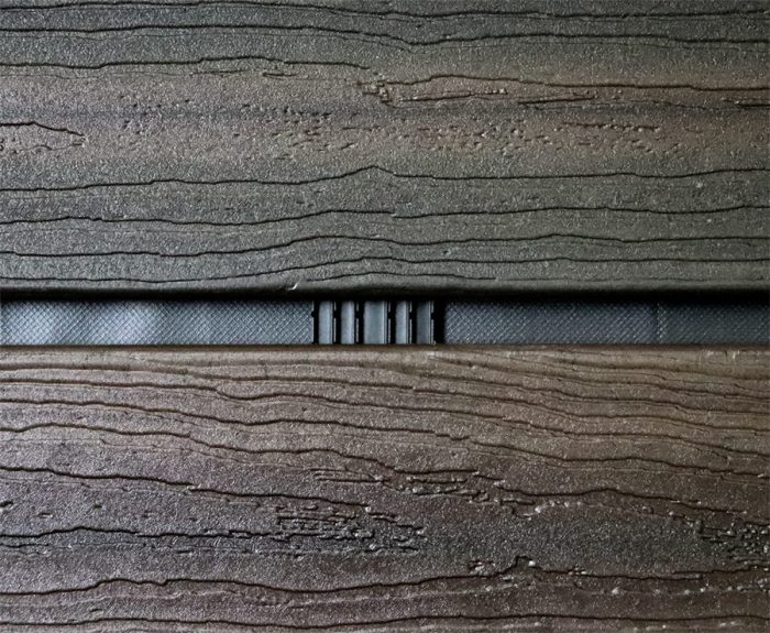

Open-joint siding is just what it sounds like: siding—often 1x material installed over battens—that is installed with a gap between each piece. Open-joint siding can be installed horizontally or vertically. One theory is that the gaps allow any water that gets behind the siding and would otherwise need to drain to the bottom of the wall or dry via convection an easier way out. Critics point out the obvious: open joints guarantee that water, critters, UV light, and the like have easy access to the WRB, flashing details, and penetrations. But lots of people like the look, including GBA member “Arkhouse.”

    "I understand people’s concerns, but my preference is to trust the science". If you are going to say your approach is based on science, (and by implication others somehow isn't) you need to cite the science you are relying on.
    "we recently finished one of the most expensive cladding systems we ever have done... It worked perfectly. Like its predecessors, it has no rot, no bugs, no mold." These are problems that occur over time. Finishing up an exterior and saying it works well I don't think is very useful commentary. And the problem isn't primarily with what occurs outside the WRB, it's whether the cladding and WRB is adequately protecting the wall behind.
    "While I didn’t do it on my recent project, testing experience on other projects would suggest that if I sprayed water on the joint, it would catch the edge of the board and ride it to the bottom. I do not think a lot of water is actually making it back to the UV membrane." That's not what the science I have seen is. RDH shows these open cladding let an awful lot of water through to the WRB: https://www.rdh.com/wp-content/uploads/2017/10/RDH-BSL-Drainage-Balance-Spray-Rack-Report.pdf

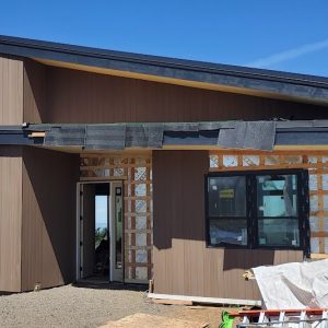

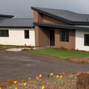

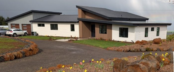

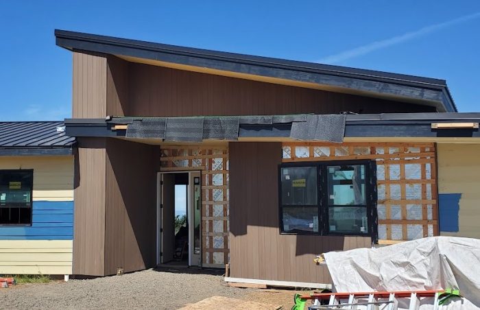

    We opted for close clad vertical siding surrounding parts of our new home in Oregon. I agree with Malcom as living in CZ4marine, I wanted the primary water barrier to be my siding. We wanted a vertical look and close to "zero" maintenance. We landed on TimberTech tongue-and-groove cladding boards over a double rainscreen over continuous rigid insulation. We achieved the vertical look, close cladding and low maintenance. Water, critters and UV degradation are hard to ignore.

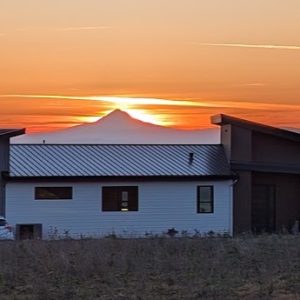

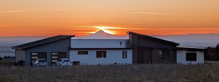

      Looks like an interesting design. Any chance of a photo of the finished house?
  7. CH_Oregon | | #10
    We integrated 3 roof styles with 3 styles of siding... The garage is simple Hardie panels with 24"oc batons over plywood with Tyvek. The main structure is ZIP sheathing/tape with either Hardie lap siding over a single rain screen or the TimberTech T&G over a double rain screen to allow vertical installation. Of course 1.5" continuous insulation is around all conditioned space.
    We worked to accentuate the entrance with the vertical TimberTech along with framing Mt Hood between the 2 shed roofs. Overall a tight build with lots of attention to air sealing details.
    Thanks to the many GBA experts who helped me bring this project to completion with solid building science principles and product installation knowledge.
      MALCOLM TAYLOR | | #11
      CH_Oregon,
      Nicely done!
    2. Chris_in_NC | | #12
      Very nice! The two masses that form the left half look strikingly close to my garage/shop that I'm designing, so you've given me a glimpse of what it could look like as a completed build.
