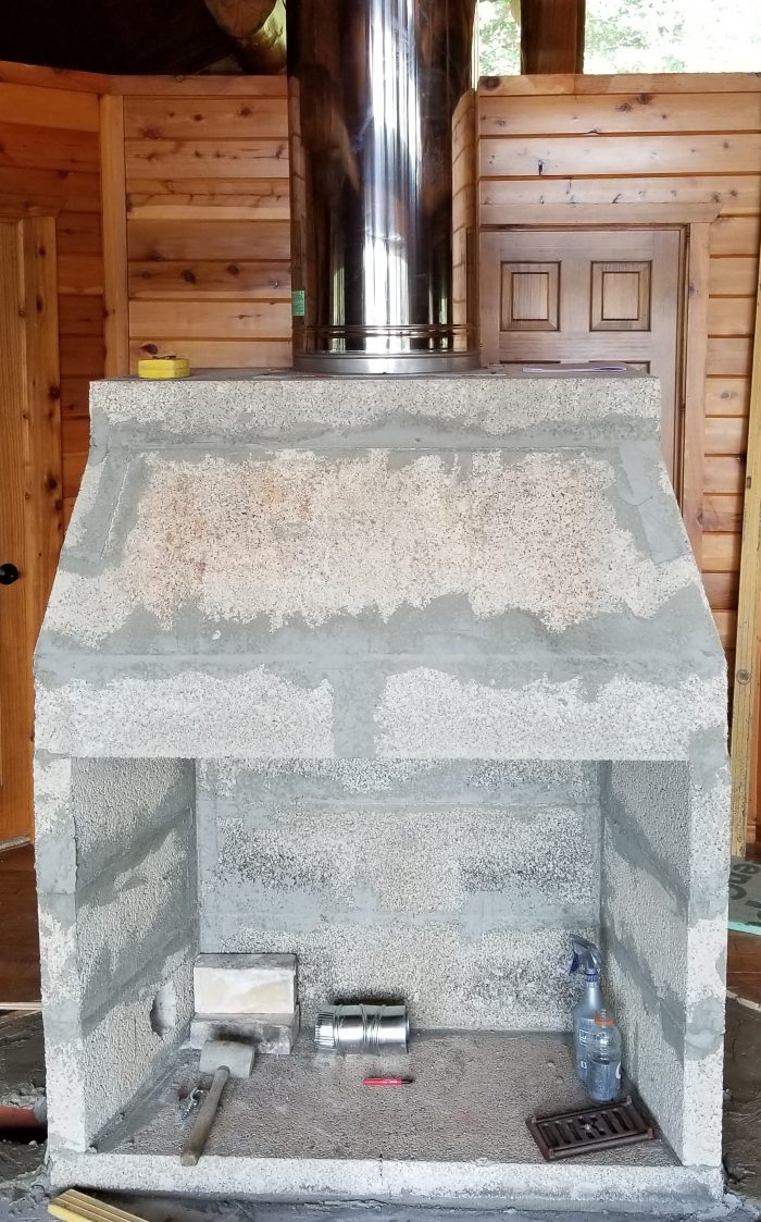

At a recent trip to the International Builders Show (IBS), I found myself walking through a dozen or so fireplace manufacturers, everything from manufactured but site-assembled wood burners (the Isokern fireplace comes in pieces that are field-assembled and uses a masonry firebox and a class A metal chimney) to gas fireplaces and gas log inserts. Most manufacturers at IBS also offered electric fireplace options.
The Isokern wood-burning fireplace kit.

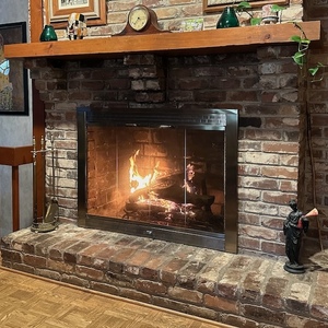

Back when wood was a primary heat source, there might have been several fireplaces located in the home. As we improved the performance of our buildings, this number was typically reduced to one central fireplace, usually located in the living room or family room. I have conducted countless energy audits over the past 15 years in homes that were built during the last century that have open-hearth or nonsealed combustion fireplaces where the current homeowner does not use the heat source. Many have been made inoperable by sealing off the flue because of drafts causing comfort issues. In some cases, rodents, bats, and insects use the fireplace as a pathway into the home. A home I used to own had a flying squirrel infestation because of the fireplace.
