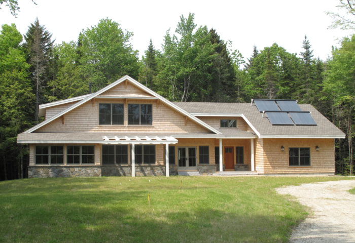

The long axis is east-west. The south-facing roof of the Freeport home's attached garage supports the home's solar thermal collectors.

The Freeport home was designed by architect Chris Briley and built by Dan Kolbert. Since the owners of the home haven’t moved in yet, the rooms are still empty of furniture.
Most aspects of the home’s thermal envelope are very well detailed. The basement walls are insulated on the interior with R-etro System foam — 4 1/4-in.-thick EPS rated at R-18. The 12-in.-thick above-grade walls are framed with double rows of 2x4s and filled with dense-packed cellulose insulation (R-44), and the insulated sloped ceilings contain 16 in. of dense-packed cellulose (R-60) in unventilated rafter bays.
The weak thermal link in the envelope is the windows. Instead of triple-glazed windows, the owners chose double-glazed double-hungs from Bonneville. The 2,600-square-foot home ended up with a design heat load of 50,000 Btuh; according to REM/Rate, it has a HERS Index of 36.
Chris Briley prepared a spreadsheet for the owners to compare several space heating options. The installation costs on the spreadsheet ranged from $20,519 (for a propane boiler and a solar domestic hot water system) to $61,908 (for a propane boiler, a PV array, and a large solar thermal system providing DHW and some space heat). The system chosen by the owners — a Viessmann wall-hung propane boiler and a large solar thermal system providing DHW and some space heat — cost $38,325.
Space heat is distributed through in-floor radiant tubing in thin concrete slabs poured over wood-framed floors. The home’s total projected annual energy cost for electricity (at 15¢/kWh) and propane (at $2.50/gal.) is $2,085.

  3. dankolbert | | #3
    Shingles
    The shingles were actually found by Annemarie Brewer herself - we bought them directly from a Maine mill - Dow Shingles in Corinth. They are 18" with a 5/8" butt - beautiful shingles, and about the cost of Maibecs with bleaching oil. We love them, and are using them again on the King/Tweed project Martin wrote about previously.
