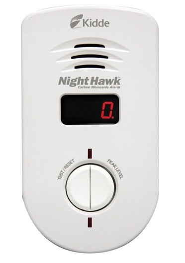

A missing safeguard. The Aspen-area home where a family of four died from carbon monoxide (CO) poisoning in November 2008 had not been equipped with a carbon monoxide detector at the time. The photo shows a CO detector manufactured by Kidde.
Image Credit: UTC Fire & Security Co.
