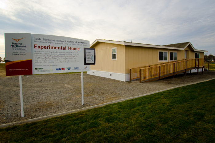

One of two test houses at the Pacific Northwest National Laboratory in Richland, Washington, where the energy savings potential of low-e storm windows was tested.

The research was carried out at a pair of 1,500-square-foot houses, identical in construction and performance, according to the lab. Researchers installed exterior low-e storm windows over the double-pane, clear glass, aluminum-frame windows in one of the houses while leaving the second house as it was. Then they measured energy use.
For identical occupancy conditions, the house with the low-e storm windows used an average of 10.5% less energy in the heating season and 8% less for the cooling season. Researchers compared air leakage, energy use, and interior temperatures during the 2013 summer cooling season and the 2014 winter heating season.
Extrapolating the energy savings for typical heating degree days and cooling degree days, the lab estimated annual energy savings of 10.1%, or 2,2167 kilowatt hours. The simple payback of adding the windows was between 5 and 7 years.
