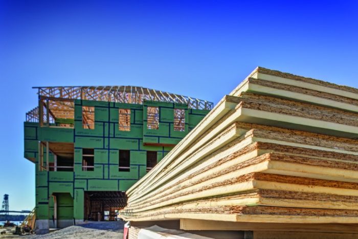

Insulated sheathing is one option for exterior walls. Huber makes Zip R sheathing that combines structural sheathing with a layer of foam insulation in thicknesses ranging from 1 inch to 2 1/2 inches.
Image Credit: Huber Engineered Woods

That said, if Farm House decides that it’s a good idea to increase the R-value of the wall assembly or reduce thermal bridging between the studs, he could take the advice of Steve Knapp and use Zip System insulated R-sheathing, which combines structural sheathing with foam insulation.
R-sheathing can take the place of conventional OSB or plywood sheathing. It comes in various thicknesses, with R-values ranging from 3 to 12.
