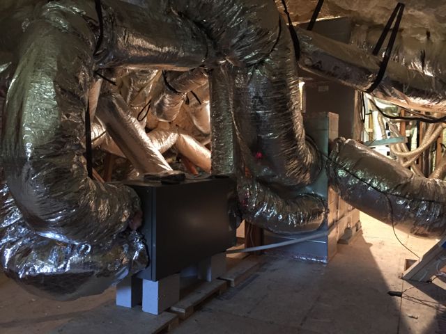

This duct monster was one of the highlights of my year. I get to see a lot of spectacularly bad duct systems in my work, and this was one of the worst.

10. My New Favorite Duct Disaster
Of course, there’s always the fun stuff like this absolute monster of a duct system. And I don’t mean that in a good way. The photo above shows part of it, but if you click the link above, you’ll see a bit more.

  1. morganparis | | #1
    Duct disaster - Carolina style
    Come across this in a first floor closet yesterday. That's the supply duct to the 2nd floor on the right, the return on the left. Homeowners were telling me their 2nd floor heating and air was not delivering the goods, and they'd never needed to change the filter on the 2nd floor return. I wonder why.

  6. morganparis | | #6
    Martin:
    The ultimate head scratchers about this arrangement are 1) as the closet doors were solid and fairly tight fitting the auxiliary return register which causes the congestion at the bottom of the closet was pretty much nonfunctional, and 2) if this useless item were not in the way there would actually be ample room for two properly sized hard ducts. Good news is the whole mess is coming out as part of a remodel.
