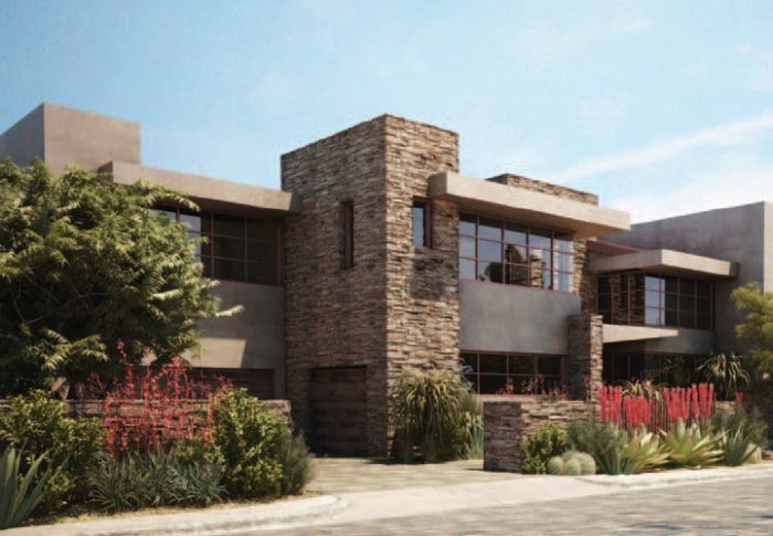

A Las Vegas showcase. New American Home 2010, in Kathryn Estates, Las Vegas.
Image Credit: Domanico Custom Homes

Built to the National Association of Home Builders’ Green Building Standard and the Department of Energy’s Energy Star Homes standard, New American Home 2010 is designed to be a showcase of energy efficiency. Among its features: an unvented, air-sealed attic with R-30 spray foam insulation on the underside of the roof deck, R-23 ICF exterior walls with an R-7 exterior finish and insulation system, an HVAC system offering 95% annual fuel utilization efficiency, airtight ductwork, an energy recovery ventilator, solar hot water, a tankless water heater, and a 10.5 kW solar power system.
NAHB has highlighted Domanico’s frustration with the credit squeeze as an illustration of industrywide concerns over acquisition, development and construction lending. NAHB also sees the project as a nod to downsized expectations in some segments of the luxury housing market, noting, for example, that New American Home 2010 is, by the standards of other homes presented in the series, relatively small. In fact, this five-bedroom single-family, with 6,078 sq. ft. of interior space, is ideal for a family of eight or nine, and it puts its energy efficiency and renewable-energy components on high-profile display. As green-construction advocates will point out, though, it loses green cred by virtue of its scale. Along with the exterior photo we’ve shown before, we’ve included here some progress photos and descriptions from a DOE press release issued in December.
