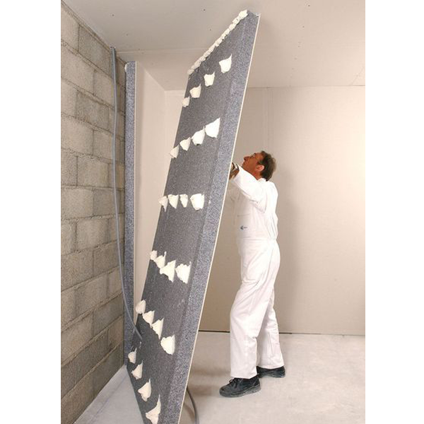

    I'm an American living in France. The most common (I'm not saying the best) residential wall construction system here is concrete block with an insulated gypsum board panel on the interior. I've attached a photo of one using GPS. EPS is also used. These are readily available even in the big box outlets. I've wondered for a while we they haven't made their way to the USA yet. They seem especially practical for a basement if you're alright with a foam insulation. And as mentioned above GPS and EPS beat mineral wool for GWP.
    Conduited wiring is attached directly to the block wall and there's enough of a gap behind the insulation to allow for it. I've also seen people groove the panel backs to allow for plumbing supply lines to be installed against the block as well.
    1. dan7210329 | | #12
      Hello jollygreenshortguy,
      Can you please state the name of "insulated gypsum board" products available in France?
      Thanks,
      Dbliss
      1. jollygreenshortguy | | #13
        #12 The stuff in most of the stores is basically generic. Lots of companies make it. But the biggest name is Saint Gobain. I believe they own Certainteed. They have a product called "Placomur". They come in a range of insulation thicknesses and plasterboard types. Here's a link to one.
        https://www.placo.fr/Produits/isolation-des-murs-par-linterieur/placomur-065-1320
