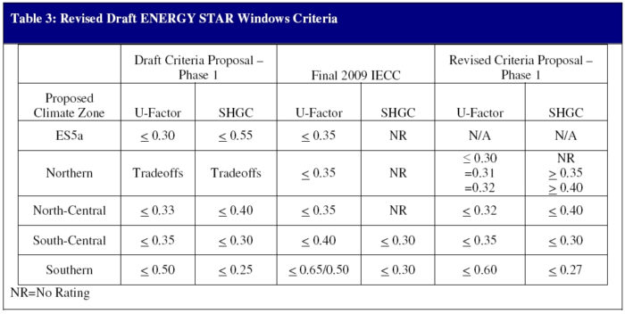

WASHINGTON, D.C. — The U.S. Department of Energy has released the latest version of its proposed new criteria for Energy Star windows. The latest draft of the proposed specification includes the following changes:
  • In the northern zone, the maximum U-factor would change from 0.35 to 0.32.
  • In the north central zone, the maximum U-factor would change from 0.40 to 0.32, and the maximum solar heat gain coefficient (SHGC) would change from 0.55 to 0.40.
  • In the south central zone, the maximum U-factor would change from 0.40 to 0.35, and the maximum SHGC would change from 0.40 to 0.30.
  • In the southern zone, the maximum U-factor would change from 0.65 to 0.60, and the maximum SHGC would change from 0.40 to 0.27.
