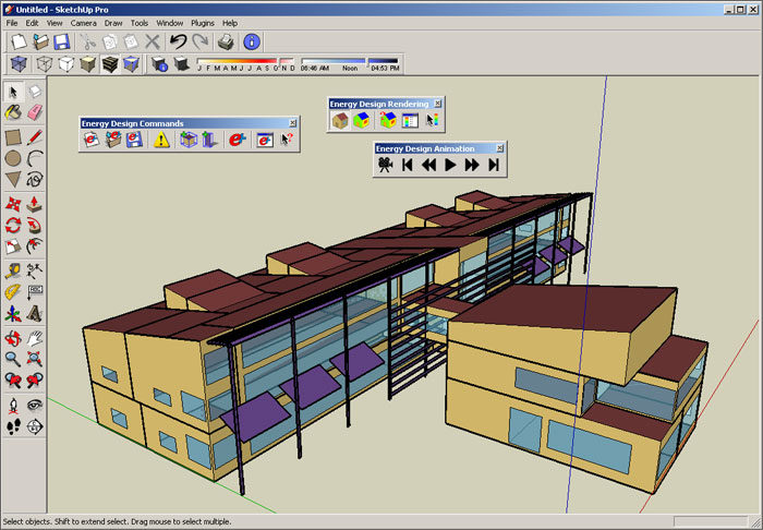

Available since April 2008, OpenStudio combines with DOE energy efficiency modeling software and Google’s SketchUp to create designs and performance simulations. And enhancements are under development
Evaluating performance and geometry simultaneously. The OpenStudio software plug-in is designed to bridge the gap between energy modeling and the building design process, says Nick Long, a NREL engineer who helps develop the software.
Image Credit: National Renewable Energy Laboratory / Google
It used to be that the Department of Energy’s principal software tool for energy efficiency modeling in buildings was EnergyPlus, a text-based simulation program for modeling heating, cooling, lighting, ventilating, water, and other types of energy flow in buildings. Then, in April 2008, the DOE’s National Renewable Energy Laboratory released OpenStudio, a free tool that combines the features of EnergyPlus with those of Google SketchUp, the search giant’s drawing interface.
That blend of programs allows architects and builders to sketch 3D drawings of buildings and run energy efficiency simulations for each visual configuration very early in the design process, when implementing changes typically is the least expensive and early insights into building performance are critical.
“Integrating energy analysis into that phase is very important because you can start to reduce energy use well before a building is even in conceptual design,” Nick Long, a NREL engineer who helps develop OpenStudio, said in a recent press release. “Our hope is that by using OpenStudio in design charrettes, users can start throwing away designs at the very beginning of a project, saying: ‘This is not a good design because we’re going to use too much energy,'”
