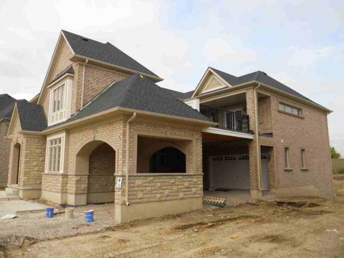

When designers create sprawling houses with multiple bump-outs, it’s difficult for builders to create an uninterrupted air barrier
This fine example of pastiche architecture would be a challenge for any experienced tradesperson responsible for insulation and air-sealing details. Typically, though, the insulation work is relegated to a low-wage laborer with little experience. This job really deserves a professional’s attention.
Image Credit: All photos: Greg Labbe
There’s a reason that every high-performance car is sleek and compact in shape; sleekness improves performance. The same principle applies to centuries-old sculptures that keep their features and endure centuries of weathering and the test of time: keep the shape simple.
Unfortunately, the current trend is to build large homes that have poorly designed floor spaces. The physical shape of these origami-like buildings impacts our lives, our comfort, and our energy bills.

Complexity ≠ Efficiency
Let’s get one thing straight: complexity works against efficiency in many ways. In many cases, things get missed in the design that have to be solved in the construction phase. Or worse: errors just drywalled and painted over.
Right from the start, complexity requires more planning and more explaining. And once construction starts, framers have to do more cobbling. Inspectors miss things, because there’s so much to look at.
Yes, the detailing for this type of building can be done properly, but it’s often overlooked. Have a look for yourself at how varied and complex the features of an origami home can be!
