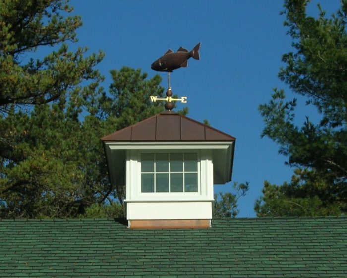

This cupola lets light in, lets hot air out, and provides a place to mount a weathervane.
Image Credit: Harborside Design
By letting warm air escape up high while bringing in cooler air from below, you can cool your house without an air conditioner.
As most people know, all else being equal, warm air rises. This is good news if you are interested in passive ventilation. Cross-ventilation with windows on opposing walls, catching the prevailing winds, is a good way to bring in fresh air when weather permits. Another great way to ventilate is by taking advantage of the “stack effect.” The cupola pictured has two electrically controlled awning windows, placed to catch the prevailing winds, and two fixed windows to keep the cost down. An open shaft leads to the two-bedroom guest suite below, bringing in natural light. When rain hits sensors mounted on the sills, the windows automatically close. Normally I am not a fan of gadgets, and I believe that one goal of green building should be to reduce electricity usage. The minor luxury of a rain sensor seems worthwhile, though, even if it isn’t completely passive.
The amount of natural light a cupola brings in depends on the size of the windows and the width and height of the shaft. In the 4-foot-square cupola pictured, enough light is conducted down the white-painted shaft to eliminate the need for daytime lighting in the hallway below. To light up or ventilate a larger space, consider stretching the cupola along the ridge into a form called a “monitor” roof (the drawing at the top of this page shows an example of a monitor roof).

    Can you tell me the window and opening mechanism details. I would like to do just what this article describes a meditation studio
    Thank you
    Don
      Michael Maines | | #4
      You're stretching my memory--I built that project in 2006 and wrote the blog post in 2009! Lucky for you I have a good memory for certain things. Those were Kolbe & Kolbe Windows (now called Kolbe Windows), awning-style operation. I just checked their website and don't see the automated hardware listed but it might still be an option. (https://www.kolbewindows.com/windows/ultra-crank-out-awning#Op134&OpT607&OpS2844&OpSI7788) There is an electric motor to open and close the window, and on the window sill is a small electronic sensor that tells the motor to close the window when it senses water. I believe other brands have similar hardware available, and there might be after-market options as well.
