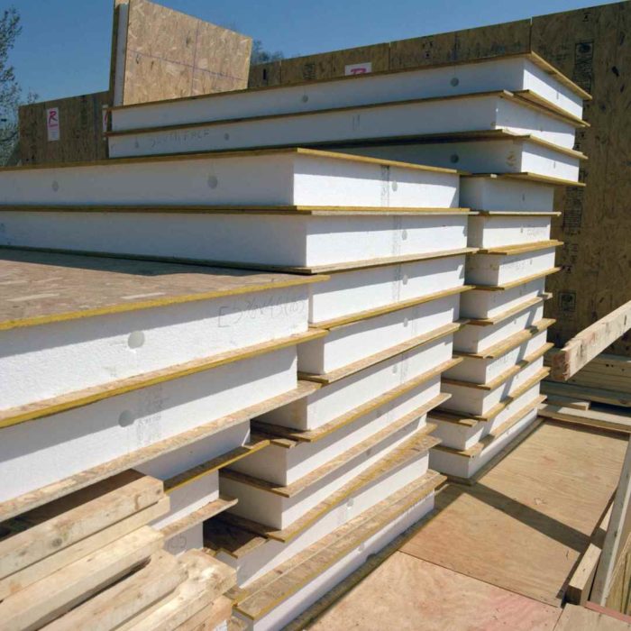

Structural insulated panels are one option that a GBA reader is considering for the R-80 walls he will need in order to achieve Passivhaus certification for his new house.

Schmidt says he has investigated a number of options and is currently leaning toward structural insulated panels filled with expanded polystyrene (EPS).
“Vacuum insulated panels sound interesting, but I don’t know if they are meant for an entire external envelope,” he adds. “The goal is to still keep it cost effective. I just don’t want a 3-foot wall to do it.”
