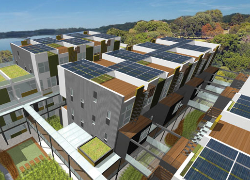

The Onion Flats Rowhouses in Philadelphia not only meet the Passivhaus standard — they also include rooftop PV arrays.
Image Credit: Onion Flats
