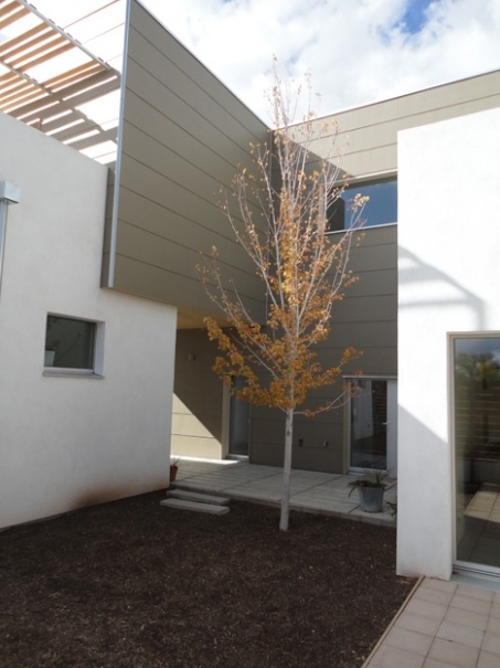

High country in New Mexico. Balance Project, a live-work condominium in Santa Fe built to the Passivhaus standard.
Image Credit: Mojarrab Stanford Architects

The Balance Project on November 10, 2010. The Balance Project includes a total of 3,450 sq. ft. Optiwin triple-glazed windows were used throughout. The Volks House, a single-family two-bedroom home being built to the Passivhaus standard in Santa Fe. The Volks House in a photo taken on October 13, 2011. The Volks House will include a photovoltaic system to bring its performance to net zero energy. A recent blower-door test for Volks House showed 0.23 air changes per hour at 50 Pascals pressure difference. The Volks House includes 1,650 sq. ft. of interior space.
Suitable as it is for the city’s high-elevation climate, Passivhaus construction has been finding its footing in Santa Fe, where design-build teams such as Jonah Stanford and Vahid Mojarrab, of Mojarrab Stanford Architects, have been building to the standard while also aiming to keep costs from skyrocketing.
One of the buildings that illustrates their approach, called Balance Project, combines residential uses and workspace in a 3,450-sq.-ft. two-unit condo. The structure’s contemporary look distinguishes Balance Project from the pueblo-, territorial-, and pitched-roof-style homes common to Santa Fe and other parts of the Southwest, but the condo still manages to blend well with the buildings in the neighborhood, a redevelopment and historic district known as Santa Fe Railyard.
What stands out is, of course, Balance Project’s Passivhaus performance and its construction costs which, at about $135 per sq. ft., came in 20% below what is typical for conventional construction in Sante Fe, according to Stanford and Mojarrab.
As noted in a recent Inhabitat photo essay on the project, its exterior walls and roof are insulated with cellulose to R-52 and R-97, respectively – more than enough thermal resistance to deal with the hot summer sun and winter cold at 7,000 ft. above sea level. The building also is equipped with a solar hot water system.
