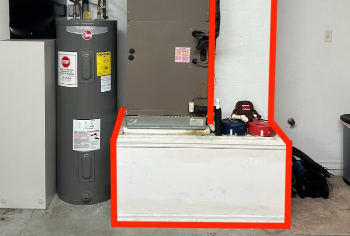

A platform return plenum is one of the easiest HVAC concepts to understand. It’s exactly what the name says it is. Before I continue, let’s look at this annotated photo, which shows how a forced-air heating and cooling system moves air.

In contrast, a platform return uses site-built ducting. It’s just a big box with the air handler sitting on top. The lead photo of this article shows our Airbnb’s platform return plenum highlighted in red. In addition, the inside of the return plenum is often connected to building cavities, like the wall behind the HVAC system.

Here’s the thing about platform returns, though: Because they’re built on-site using nonstandard duct materials, they often don’t get sealed up well. And because they’re on the return side, those site-built, potentially leaky ducts are under negative pressure. Remember, the blower is pulling air back from the house through the return side of the duct system.

So what could go wrong? The best-case scenario is that the platform return is inside the house and sealed properly to prevent pulling in dirty air. That’s kind of what we had in our Airbnb last year (photo above). The garage was on the other side of that air-handler closet, though, so there may have been some connections to the bad air there.
But when you put the system in the garage on a platform return, you’re just asking for trouble. When the return ducts leak there, a lot of bad pollutants can get pulled into the system and then distributed throughout the house. That could include:

Worse, if the garage has a natural-draft gas water heater, the negative pressure created by return leakage could cause it to backdraft. That simply means the exhaust gases from the combustion don’t go up the flue and out of the house. Instead, they get pulled into the garage. From there, they can get pulled into the duct system from the return leaks and then be sent into the house. A clothes dryer in the garage also can cause the water heater to backdraft.

If you have a platform return plenum—especially one in the garage—you should line it with approved duct materials and make it as airtight as possible. And don’t forget the filter slot!
