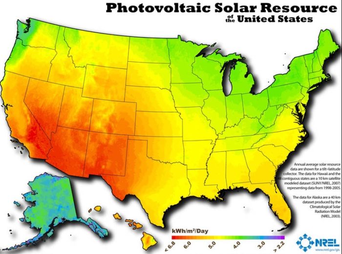

The geography of PV potential. This map shows the solar power potential for the U.S., expressed in kilowatt hours per square meter per day. The data is based on average annual solar exposure in each region, with red representing 6.8 kWh/m2/day, orange a 6.0 average, yellow 5.0, green 4.0, blue 3.0, and purple 2.3.
Image Credit: National Renewable Energy Laboratory / Billy Roberts
