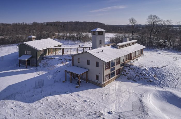

Marti and Tom Burbeck think about things like the shrinking Arctic ice cap, the global pandemic that is plastic pollution, and who might inhabit their home 200 years from now. So it is not surprising that the couple was drawn to the Living Building Challenge (LBC) when Michael Klement, principal of Architectural Resource, introduced them to the building certification program. It was an arduous road they chose to travel but after 3-1/2 years in design, 18 months in construction, and a year of performance auditing, their home is the second of only two LBC-certified private residences in the world.
Set on a pastoral swath of land in Ann Arbor, Michigan, Burh Becc at Beacon Springs Farm comprises 30 acres, a 4970-sq.-ft. Tuscan farmhouse−style main house, and a 2440-sq.-ft. barn/workshop/garage. It is a zero-waste, net energy−positive building whose operation contributes to the health of both its occupants and the natural surroundings.
Once an oak-hickory savanna, the site was in poor condition when Tom and Marti came to it. The land had been farmed for decades and was severely compromised. “The property has a lot of rolling hills, and at the edges of the old farm fields the grades were typically 2 ft. lower than the hedge rows around it, suggesting there had been a lot of erosion with the type of agricultural practices being used,” explains landscape architect Shannan Gibb-Randall of InSite Design Studio. “The fields had typical old-field meadow species—some natives but a lot of weedy invasive species too. The hedge rows were also choked with woody invasives like buckthorn and honeysuckle.” In short, the site met the LBC condition that projects can only be built on greyfields or brownfields.

      1. For just two people, this home is massive. 5,000 square foot house AND a 2,500 square foot garage? Nothing against huge homes- but for only two people, can you really call yourself "green"?
      Michael Response: Rick, understand your concerns about square footage. We noted that there was an error in the published square footage. The actual square footage of the net living space not including mechanical, plumbing pit and un-finished basement storage space is 2,880. Rick you are absolutley correct that additional square footage does have a compounding negative impact on the sustainability of a home: embodied and operational. However, in this case, our home owners considered that creating a farm homestead intended to last for 200 years that although only serving two currently, that they wanted to create a home that embraced the sustainable principle of ‘long life- loose fit’. That very likely after their tenure at Burh Becc at Beacon Springs that the next family may have children, or be an extended family, or be multi-generational, or even multi-family with farm hands all under one roof. I'm with you on this challenge, Rick. The thing that I have the opportunity to shift my thinking on is that there is some ordaned magic number for a home's square footage that is considered annotable as 'sustainable'. I'm slowly being pried off that point of view- this project helped me to do that.
      Rick's Comment 2.) Choice of Insulation: I personally love rigid foam as exterior insulation. But I also admit that it is not very 'green'. The article mentions the SIP roof (EPS). But quick research shows that the exterior walls consists of a layer of Thermax (Polyiso) and an exterior layer of... wait for it.... XPS! The slab and foundation walls are also all XPS. (Facepalm) See link below.
      Michael's Response: Rick, could not agree with you more. We first started the design of this project in 2012. If we were to do it all over again, knowing what we know now about embodied carbon and GWP, we would have done it completely differently. Hind sight is 2020. At that time we were focused on operational carbon (energy efficiency).
      Rick's Comment 3.) High Embodied Energy Materials: I see a lot of concrete and stucco, brick, tile, and steel. These are necessary in a building at times and I get that. But, there are greener alternatives here.
      Michael's Response: Again, having a chance to do it all over again, we would have taken a different path. In fact we are currently working on several Passive House projects where we are focusing exclusively on a new, space-age material that appears very promising: wood.
      Rick's Comment 4.) Loads: This home is in zone 5, +/- 6,000 HDD each year. Yet this home for two people uses 10,000,000 Btus in heat each year. This isn't great. My home for two in an 8,000 HDD uses 6,300,000 BTUs per year. Sure, it is lower than the PHI standard per square foot. But the home is massive so this shouldn't be a surprise. The real question is how many btus per year, PER PERSON? Again, this home does not show up well here. Try the metric with PHIUS (not PHI) and see what happens. Also, it's easy to hit the PHI ACH figure when your home is the size of a Tuscan castle. Again, try it using the CFM metric from PHIUS.
      Michael's Response: See above
      Rick's Comment 5.) A home in a colder climate shouldn't try to rely on thermal mass. The south side of the home is stuck in the 70's and has way too much glazing. See #6.
      Michael's Response: Perhaps, but we are finding that it is actually performing very well and the homeowners are quite pleased… and comfortable.
      Rick's Comment: 6.) Net Zero Energy: just because the home produces more electricity in a year than it uses doesn't mean it doesn't use a lot of energy. Given the size of the home and the massive % of glazing, this home probably becomes an energy hog on cold nights and cloudy days. It isn't off-grid. The grid is using a lot of energy to keep this home warm. This home doesn't need the electricity when the sun is out given all of the windows. 16kwh is a big PV array to have to hit net zero on a new construction project.
      Michael's Response: Agree that 16kwh is a big PV array. Biggest one we have ever put on a home. The intention was to be sure that we achieved Net Positive energy. And we have, including charging an electric vehicle, and enough surplus to charge another two.
      Rick's Comment: Conclusion: It's hard to get behind a program like the Living Building Challenge when they endorse and champion a home like this.
      Michael's Response: No doubt the Living Building Challenge program has its faults and is evolving even through discourse such as this. Hopefully some of your misgivings about this project are addressed with our clarifications and comments. I’d invite you to consider the entirety of the Living Building Challenge. Although certainly important, the LBC is about more, a lot more, than energy/embodied carbon/GWP. Take another look and see what you might discover!

    A key to this project is in the title of the article--"Proof of Concept." I don't see this as a house that's going to be adopted for the mass market, or that the vast majority of consumers could come close to affording a house like this. Some of the elements used, like the XPS insulation and the SIPs roof, we know are not good for the planet, and may even be net negatives. In contrast to projects that follow The Pretty Good House approach, targeted to those who want an achievable standard, this project is not meant to be adopted by the masses.
    This is that I would call a "leadership project." LBC is very difficult to reach, but I think of projects like this as prototypes to test the science and viability of different approaches. Of course the size is much higher than a couple should need, and I would bet that this is not their only home. I've been in a lot of 10,000 to 20,000 sq. ft. second or third homes that are all code-minimum spray foam and don't even try to be environmentally responsible; I'm sure the owners of this project could afford to do something else, but chose to showcase what could go into a Living Building Challenge house.
    The cooling tower is a cool idea. Many of us dismiss Trombe walls and over-glazing, but maybe they're worth reconsidering in some situations. Building on brownfields, creating more energy than you need (reaching net positive with a 14kW PV is an achievement for a house this size). While we aren't going to save the planet building houses like this one, maybe there are elements we can adopt, or maybe just having conversations like this are a beneficial. It used to seem impossibly hard to reach Passive House levels of energy efficiency and airtightness, but the builders I know now compete to see how far below 0.2 ACH50 they can get. 1.0 ACH50 is a cake walk in comparison. We didn't get there without Passive House leadership projects (and practitioners) paving the way. Projects like this LBC house chart a course that others can follow, hopefully in a more achievable manner.
