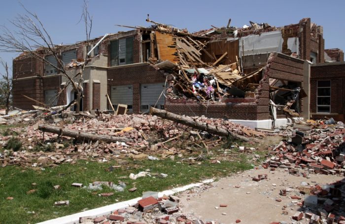

After a tornado: Greensburg, Kansas, was all but wiped out by a tornado in 2007. Townspeople chose to rebuild as a model green community in what could be a lesson for other communities facing the same problem.

Tornadoes have struck the Midwest with a vengeance this year, killing dozens of people and causing widespread destruction of property. In the city of Moore, Oklahoma, a tornado with winds topping 200 miles per hour struck on May 20, reducing whole neighborhoods to rubble.
