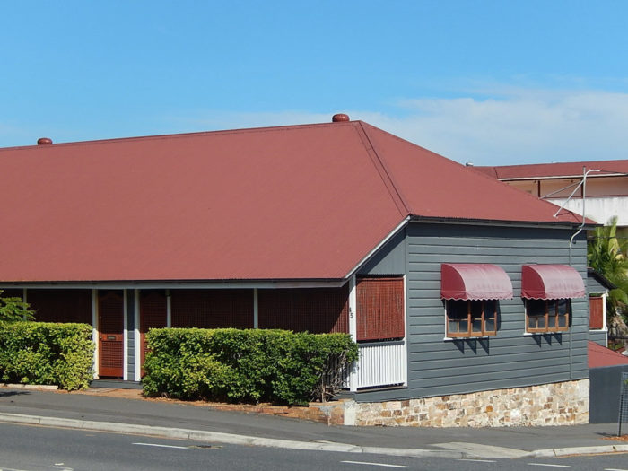

Ruby-red roofs as cool as a white roof? Researchers at the Lawrence Berkeley National Laboratory think they've found a way to keep dark-colored surfaces like this just as cool as more reflective white and pastel colored surfaces.

    I am curious the cost if it makes it to mass production, and does anyone else think that roof likes like one continuous piece. Not sure if its just the photo or thats how it actually looks. Some will be turned off by that, but it could also be the new in style (and i'm sure that can be changed anyways)

    There is nothing about aluminum oxide that makes it suitable only for metal roofing (as in the picture). It could as easily be applied to asphalt shingles, or even a mop-on coating for torch-down roofing. It has long been used as an abrasive in sandpaper & fingernail files.
