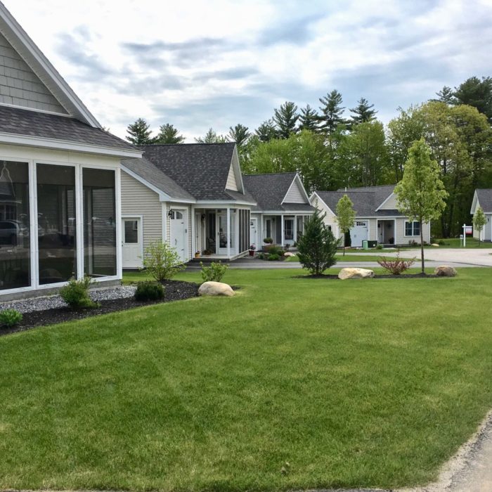

Houses in the second phase of a planned 60-unit subdivision are half again as spacious as the originals. The developer says that buyers are asking for more space, but still seem happy with a footprint of less than 1,000 square feet.
Image Credit: Scott Gibson
With the launch of The Cottages at Willett Brook, Justin McIver thought he’d found the ideal house size for 55-plus buyers who were ready to downsize but weren’t interested in squeezing into a house of just a few hundred square feet. Turns out he was almost right.
McIver planned to build the 60 single-family houses in Bridgton, Maine, in phases of 10 houses each. The 10 units on A Street came in two sizes — 610 and 640 square feet. That was two years ago. McIver’s company, Maine Eco Homes, has since completed the second group of houses, on B Streeet, but this time they measure from 700 to 924 square feet, an increase of as much as 50% over the originals. And McIver doesn’t see much changing as he moves ahead with the next 40 homes.
“The smaller houses were going great, but we had a lot of demand for something a little bigger with an attached garage, and a bath and a half,” he said. “That seems to be the sweet spot.”
Just down the hill, work is underway on the third pod, where the houses also will be in the 924-square-foot range, possibly a little bigger. McIver says he’s accepted reservations on several of those houses already. If buyers ask, those houses can be made slightly larger, and they’re coming with amenities like a porch on both front and back. Some have walk-out basements.
Even after growing by 50%, the houses are smaller than the average American home was in 1950 — 983 square feet, according to the National Association of Home Builders — and a fraction of the 2,422 square feet median for single-family homes built last year.

The Cottages at Willett Brook, a 55-plus development in Bridgton, Maine, is heading into phase three, featuring larger houses, higher prices, and more amenities.
Houses originally were framed with 2x4s and raised-heel-truss roofs. Exterior walls were insulated with 2 1/2 inches of closed-cell spray foam and sheathed with Zip System R-Sheathing, which includes a layer of rigid foam insulation. Newer houses are framed with 2x6s 24 inches on-center with stud cavities filled with open-cell spray foam, McIver said. The rigid foam on the outside has been eliminated. Roofs of the newer houses are insulated to R-60 with a combination of spray foam and blown-in cellulose.
