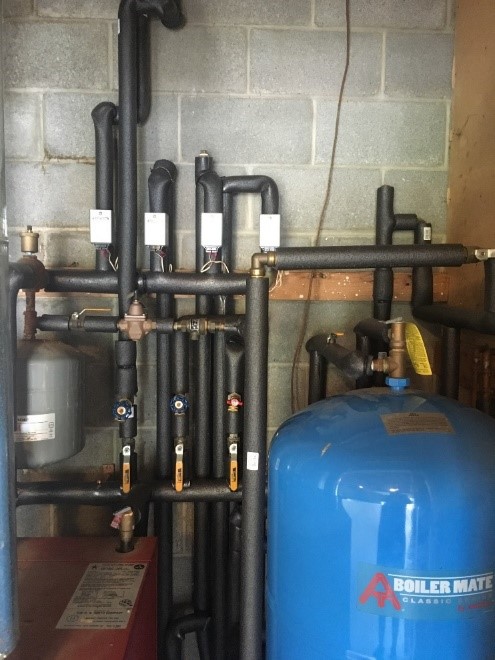

Insulating hot water lines and hydronic heating pipe saves energy and money. It's nice when it looks good, but more important is performance.

Pipe insulation is one of those humdrum efficiency measures that gets little attention beyond its perpetual appearance in lists of “simple things you can do to cut your utility bills.” But it delivers a surprising list of benefits. The first, of course, is saving energy. According to the Building America Solution Center, insulating pipes can reduce water heating energy use by 4% to 5%. For a typical household, this can translate into savings of $15 to $30 per year.

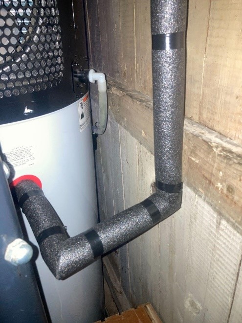

One way pipe insulation saves energy is by reducing standby losses from hot water storage tanks. While the jackets of modern water heaters are insulated with a thick layer of polyurethane foam, the metal or PEX inlet and outlet pipes can still conduct heat, as can other fittings like the drain valve and temperature/pressure-relief valve. Thermosiphoning can also contribute to standby losses; hot water rises into the pipes, cools, and flows back into the tank. Pipe insulation slows both these processes. (Many modern water heaters have “heat traps,” small flaps or balls on the inlet and outlet ports, which also reduce convective losses.)
Pipe insulation for an energy efficient house
Insulate the pipe all the way to the water heater.

    (1) Tape the entire joint: Foam pipe sleeves have a self-adhesive face; simply peel off the cover and stick 'em together. The problem is that (a) you get what you pay for, and foam pipe sleeves are cheap, and (b) this cheap adhesive gives out over time, opening the foam sleeve to the cool air in your basement - and the foam sleeve doesn't fit tight, so air circulates, robbing you of much of the benefits. Believe me, I've seen this failure. So... run HVAC foil tape down the length of the joint. Note: HVAC foil tape is NOT silver duct tape - which should NEVER be used for any HVAC project! For example: Nashua https://www.homedepot.com/p/Nashua-Tape-1-89-in-x-50-yd-322-Multi-Purpose-HVAC-Foil-Sealer-Duct-Tape-1906075/100030120 This tape sticks forever.
    (2) R3 - really? As you noted, basic foam sleeves deliver only R3. No one would insulate a wall to R3, so why would you do this with pipes you've paid to heat? Unlike an entire house, which is difficult to insulate and air seal, here you have a 'point source' problem you can solve! You can simply wrap the foam sleeve with a fiberglass sleeve. For example: add a fiberglass wrap OVER the foam sleeve, to add another ~R3. Again, tape the joint. https://www.homedepot.com/p/1-1-2-in-x-3-ft-Fiberglass-Self-Sealing-Pre-Slit-Pipe-Cover-F14XAD/100134569
