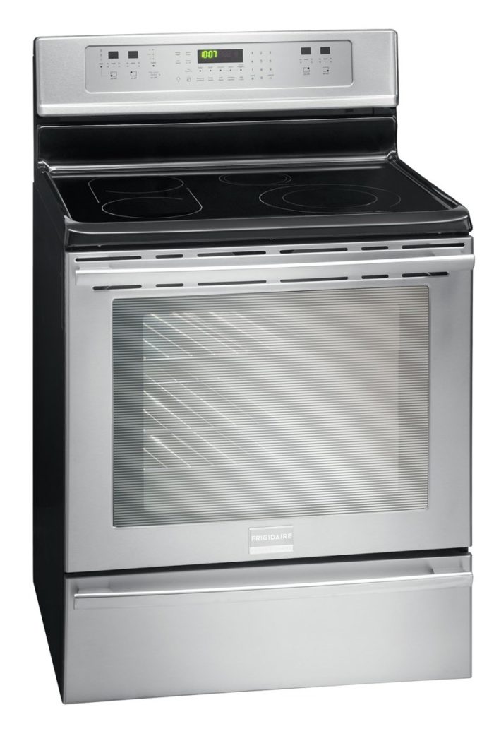

For the first time in my sheltered life, I have a range with a self-cleaning oven. After over a year which included roasting a number of chickens (which we’ve been raising the past few years), we had an oven covered with enough spattered grease to cause the smoke detector to go off any time we turned the oven on.
The manual that came with the range cautioned against using the usual oven cleaners and recommended the use of the self-cleaning feature. This process locks the oven and heats it up to a very high temperature — Wikipedia (among others) says 900°F.
I was curious what this would be like: Would the range feel really hot to the touch? How much would it smoke? Would it actually clean the oven? How much energy would it use?
Smoke spews out of the oven vent
You have to clean any serious accumulations of stuff out first, perhaps so it doesn’t combust. Also, you’re not supposed to leave the racks in — they warn against the high temps destroying a finish that makes them slide easily.
This was a major bummer, since we’d been dumb enough to leave the plethora of racks this range comes with in the oven while we only needed one to roast the chicken :- Duh.
They were really grimy and we (OK, not we, Jill) cleaned them by hand. Note to self…
Once we started the process, the oven heats up quickly and smoke comes spewing out the vent. We had windows open and the range hood running. In the first hour of the three-hour cycle the visible smoke stopped. I didn’t abort the cycle because I thought I should go through it at least one time. The front and sides of the range felt surprisingly un-scary in terms of temperature — there might actually be some reasonable insulation in there.
Once it turns off, the door stays locked and it indicates on the display that it’s still hot for close to another hour, until it cools down.
Result: a clean oven
It did get pretty clean, and there was some ash remaining. And the entire process used 8 kWh of electricity.
That night we had friends come to share homemade pizza, so we added another 3 kWh. The day’s total of 11 kWh exceeded our usage tally for the range in some months!

    I usually get away with leaving the racks in, along with the porcelain-finished broiler pan, pizza stone, and whatever else I can think of. A little vegetable oil fixes the sliding.
    It is indeed a smoky process, and it would be a bit less energy-wasteful if the exhaust were not so noxious. Gas ovens seem designed to waste a huge amount of energy, since the burner vents into the oven, and the exit flue has no automatic damper to keep hot air from leaving when the burner is off.

    As I read this blog we are 3 hours into the supposed 5 hour cleaning cycle of our electric range. It has been in service 4.5 years and baked many fowl.
    What occasioned today's decision to clean was the pool of apple pie overflow at the bottom of the range caused by my dear mother's overstuffed pies.
    I didn't think to remove the racks, mostly because I didn't think to read the directions...as a male engineer I normally consider myself above such details when dealing with pedestrian household appliances...OOPS!
    When I started the cycle I had a twinge of regret, thinking that I should do it tomorrow, when the evening temperature is forecast to drop into the 30s, as opposed to today's 60s...I figured the extra heat would offset some heating costs if I had waited for chilly weather.
    I'm sure glad I did NOT wait for a colder day...the voluminous smoke caused us to crank the range hood to speed 11 and open several windows. I'm not sure how we avoided setting off the smoke detectors and waking Christmas-addled children from a welcome sound sleep.
    We have our range on a channel of a TED energy meter, and it looks as though the self clean cycle will burn at least 9 kWH, 1/3 to 1/2 of a typical month's range energy usage.
    Update - per TED, self clean consumed 8.22 kWh, and there is quite a bit of white ash dust, so I guess it worked.

    A self cleaning electric range is far better insulated than a standard range. It has to be, to prevent setting fire to the house when the oven is at 900F. Therefore it uses less energy each time you are roasting or baking anything. I read, years ago, that they actually save energy over a conventional oven, and you don't have to use harsh chemicals to clean them.We use a small counter top unit for broiling.
    We have been using them for decades and the new ones still say not to leave the racks in, but we do. We also put the surface burner drip pans in during the clean cycle. If your drip pans cannot be put in, then buy some that can withstand the heat.
