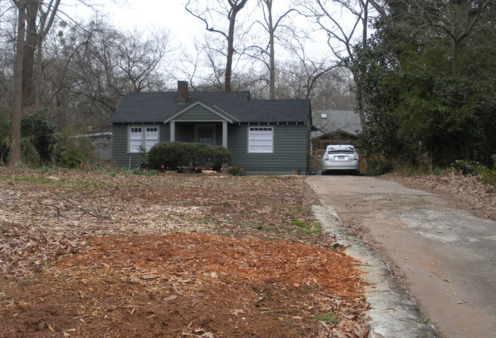

Work on my house is almost done. The landscaping and paving haven't started yet, so there is still is a lot to do.

The porch is finished except for screens, which will be necessary in a few weeks when the bugs start coming out. If you haven't yet tried the Delta H2O Kinetics showerhead, check it out. The flow rate is only 1.5 gpm, and it feels like a real shower. I was told that it is the same technology as auto windshield washer sprayers. I lived with this compact, functional, but pretty ugly kitchen for many years. Just a bit nicer, don't you think?

The last piece of my renovation puzzle is the landscaping. Not being very interested in yard work, I am attempting to develope a low-maintenance/low-water-use landscape plan.
My challenge is that I have a large yard — 75 by 200 feet — that, with the exception of the house and a few large trees, is pretty much devoid of any landscaping. I need to replace my driveway, move one retaining wall and remove another, do some grading, manage site drainage, and install a boatload of plants and trees.
The current plan is to use some of the salvaged driveway for edging and paving blocks, install a gravel drive, and install patios of pea gravel or crushed slate in front of the house. Plans are evolving, budgeting is underway, and work should get started sometime in the next month. I’m not really looking forward to this part of the process, but definitely will happy when it is complete.
