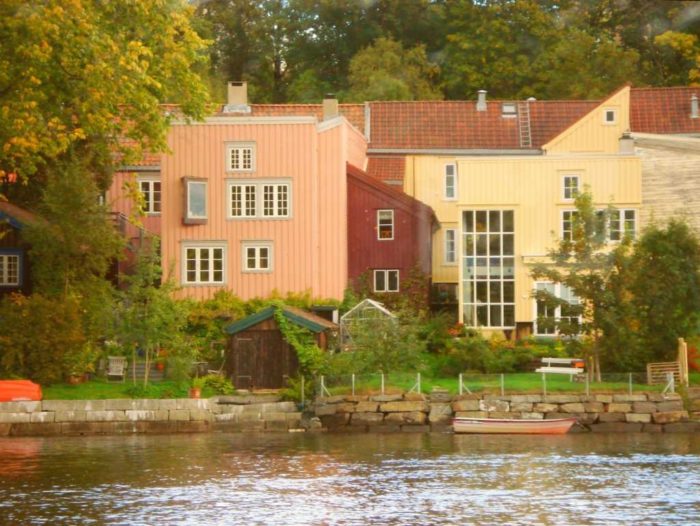

Windows in Trondheim, Norway
Image Credit: Carilynn Balbo
Window design helps make the most of your site

Ganged windows catch the view
Two or more windows grouped together will capture a panoramic view better than separate units individually placed around a building. Even if the view is only a small yard, ganged windows bring in natural light and make a room feel bigger than it would with separate windows. Smaller windows are friendlier because they are easier to access than huge plate-glass windows, and they are more easily made operable — a necessity for a low-energy, naturally ventilated house. Mulling windows tightly together maximizes views, but stud pockets between windows allow for structural support. More support means smaller headers
and more insulation. Mixing and matching pane sizes might work, but keeping the height-to-width ratio the same (as in the photo at right) ties the disparate elements together.
