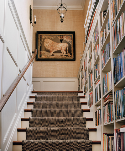

Could the design of these stairs be improved? Perhaps. Wider treads and shorter risers would probably improve the safety of the stairs, and the sconce at the top of the stairs makes furniture moving awkward. But the bookcase on the right side is a nice touch.
