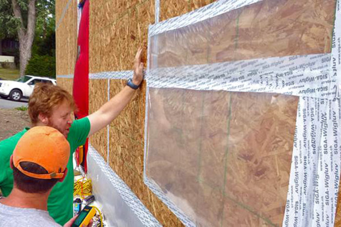

This photograph of an OSB-sheathed house in Pennsylvania helped prompt a study of how effective OSB is as a designated air barrier. A piece of polyethylene taped to the sheathing billowed outward during a blower door test, indicating the panels were leaking air. RDH Building Science tested that possibility in the lab and recently reported its results. Photo courtesy Richard Pedranti.
Recent tests by a building science research firm have backed up anecdotal evidence that at least some brands of oriented strand board (OSB) sheathing are too leaky to be considered effective air barriers.

Richard Pedranti, the architect who helped get the ball rolling with his failed blower-door test, would agree. Reached by telephone after the podcast had aired, Pedranti said his 2015 project was instructive.
“We stopped using OSB as a designated air barrier after our experience,” he said. “There’s no gray area there. It’s either Zip, plywood, or a membrane.”
That house was Pedranti’s first attempt at getting a very tight envelope, his first Passive House. He had talked with colleagues and leaned heavily on the Passive House building community for advice. He went with OSB. After a frustrating several hours of trying to track down the source of air leaks during the blower-door test on a sweltering summer day, Pedranti’s building science consultant suggested the problem might be the OSB itself. “No way,” Pedranti remembers saying, but the test with the plastic film captured in the photo above proved the consultant right.
“We had a low budget for the house,” he said. “OSB seemed like the obvious choice. Not in a million years did I think we would have a problem with OSB.” The solution for him was a membrane made by Siga, which he applied over the OSB. That worked.

    Martin had an article on this very subject in 2014 (with the same picture)
    https://www.greenbuildingadvisor.com/article/is-osb-airtight

    Call me a skeptic here, but there's a lot to be desired in this whole setup.
    1. If you're going to test ZIP against a competitor, lay it out there. You'd better be telling me who you're better than, so that I can go buy a sheet of their osb and test it myself. Take a note from Banks, grab the hair on your chest and stir the pot :). Otherwise a manufacturer can't come out and say hey, no dice. Here's our test data that shows otherwise! This gives nobody the opportunity to rebut their claims. The results are too good (bad?) to be believed. Besides, per dollar, they should have tested it against 5/8" or 19/32" osb. It's not the thickness that counts per se, rather the cost per square ft of material, installed.
    2. I didn't read the study, but if the airworthiness of osb is questionable, then why tape a giant section of plastic over seams that are taped, and may have other sources of leakage? In that picture, it's impossible to say wether or not it's the osb that is leaking air, or if it's coming from any of the seams where the tape can bridge the very small gap due to the roughness in the surface of the osb. There are nail penetrations there as well, even as mentioned in the article. Surely a cubic foot box test or so with an air chuck and pressure gauge would have been a more definitive "Is this material leaking" test. Do we need to find a better material, or a better way to seal the penetrations in that material? I'd point to the latter.
    There are plenty of homes built with osb that are < 1 ACH50. This feels like an invisible boogeyman that's sponsored by Huber.
    Not that I don't like Huber, they make great products. This test just leaves too much to the imagination for me to slam a fist on the table and proclaim "That's it boys, it's zip or nothing from here on out."

    2. Jon_R | | #30
      > why tape a giant section of plastic over seams that are taped ...
      Good point - include the taped seams and I'd call it an assembly, not a material.
      Was primer before the tape used in all of the OSB tests? It's recommended for a rough surface.
      1. mn_johnb | | #31
        It's my understanding the photo was from the field build that initially prompted the study, and that photo doesn't depict the actual procedure used. But the same thought occurred to me, if the poly is billowing out over a taped seam, the seam is the culprit.
