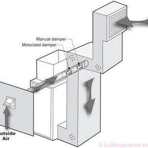

Ventilation is important. Having a supply and exhaust ventilation system is ideal. When the supply air comes from a known location where it brings in the best possible air from around the building, it’s even better. I don’t know where the supply air was coming from in this hotel, but I think I’d have noticed if it was coming from the street level, or worse, the parking deck.
And the absolute best would be to have a balanced ventilation system (equal supply and exhaust) with recovery of heat and, in most places, moisture. Still, I’m really happy to have had both supply and exhaust ventilation in my room at the Seattle Hyatt Regency. Kudos to them for doing it right!
