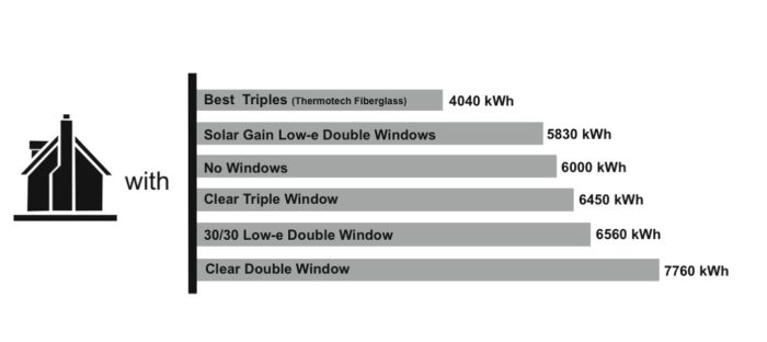

Five different glazing options, along with the option of having no windows, are shown here for a highly insulated house in the Boston climate. Shown are the annual combined heating and cooling loads. Energy modeling was done by Bruce Gough of Energy Building Group using the Minto Inspiration house as the baseline.

The problem is that it sets a maximum “solar heat gain coefficient” for windows of 0.30. Solar heat gain coefficient (SHGC) is a measure of transmissivity–how much solar energy gets through the window. A SHGC value of 0.30 means that just 30% of the sunlight is transmitted. Such a low SHGC is a good idea in hot climates, especially on east- and west-facing windows, to prevent overheating. But it doesn’t make sense in northern climates where we want to benefit from the warmth from sunlight–as in solar tempering or passive solar heating.
To the credit of the policy makers, with the Recovery Act there was an effort to create a more rigorous standard for window performance. Along with the SHGC 0.30 limit, they established a maximum U-factor of 0.30. U-factor is a measure of the amount of heat transmitted through a window–the lower the number the less heat gets through. U-factor is the inverse of R-value, so that a U-factor 0.30 window would have an average R-value of 3.3. This is a “unit” value based on standards from the National Fenestration Rating Council (NFRC), meaning that it accounts for heat loss through the window edges and frame as opposed to just the “center-of-glass” value.
A window with a unit U-factor of 0.30 is fairly good. To get to that level of performance, it needs to have insulated glass with a low-emissivity (low-e) coating and a low-conductivity gas fill, such as argon. I would have liked to have seen it even tighter–say 0.25 or 0.20 to create demand for triple-glazed windows–but 0.30 is a lot better than what was required under EPAct.
To achieve both the 0.30 SHGC and 0.30 U-factor requirements, you have to use glass with a special low-e coating, such as the LoE3 glass made by Cardinal Glass Industries.

Stephen Thwaites of Thermotech Fiberglass Festration in Ottawa argues that in a northern climate even if the same glazing is used on every side of the house, a higher-SHGC glazing will significantly reduce energy consumption. Thwaites and an associate carried out energy modeling for me to make that case, as shown in the accompanying chart. In the Boston climate, based on HOT-2000 modeling runs of the highly insulated Minto Inspiration House in Manotick, Ontario, using 30-30 windows throughout the house results in a combined heating and cooling load of 6,560 kWh. When the house is modeled with higher-SHGC (0.48) and somewhat lower R-value windows (U-factor 0.34), the annual energy use for heating and cooling drops to 5,830 kWh (11% lower). Several other options are shown in the graph, including the best triple-glazed option from Thermotech.
“With very few exceptions,” according to Thwaites, “a low-e window with a SHGC of 0.30 or lower is a bad window for houses in heating climates.”
So what should we do? The answer is actually fairly simple: Use the 30% window replacement tax credit only for non-south-facing windows. For south-facing windows, skip the credit and install windows that transmit a lot more sunlight (SHGC of at least 0.45). In fact, maybe we can use the requirements of this new tax credit to finally get some traction for the idea of “tuning” windows by orientation (using different glazings for different orientations).

    It's an oversimplification to say that "to raise SHGC you also raise U-value." There is such a thing as a high-SHGC low-U window. In general, the hard-coat low-e coatings provide a higher SHGC than the soft-coat low-e coatings -- while still providing lower U-factors.
    And while you may well "diagree" with the idea of using high-SHGC windows in northern climates, it's not really a question of agreeing or disagreeing. Heat gain and heat loss is a matter of physics, not opinion. These heat gains and heat losses can be measured and modeled. Anyone who lives in a cold climate and chooses low-SHGC glazing over high-SHGC glazing is throwing money out the window -- because their heating costs will be higher than necessary.

    What about a house with a massive amount of glass facing West, for example, due to owner's requirement for view? In this case a low SHGC is helpful, as overheating is a factor = expense for cooling in the summer.

    You're right -- and that's what a good energy modeling program will reveal.
    In many cases, the ideal glazing choice differs for each orientation. The best glazing choice for the west orientation is often different from the best glazing choice for the south orientation, so the house ends up with orientation-specific glazing.
    The process is best performed with an energy modeling program like PHPP.
