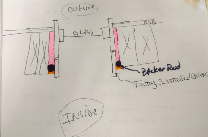

In a recent Q&A post, homeowner “tjones1014,” whom we’ll just call T Jones, is helping to remodel his house. He writes that he’s having a hard time sealing the gap with spray foam, without completely filling the gap. “We want to leave a small path for water to exit, as our sills are sloped toward the exterior,” he says. “Is putting backer rod in the gap before spray foaming to control the depth a decent solution to this?””

      I think we all had the window-and-door type of canned foam in mind when providing our experiences and opinions. It holds water like a sponge and it's not a reliable air-seal in tight spaces.

      The consensus in this blog and elsewhere seems to be that relying on any foam as the air-barrier isn't a good idea. I'm with Michael Maines: I haven't used foam around windows and doors for years.
