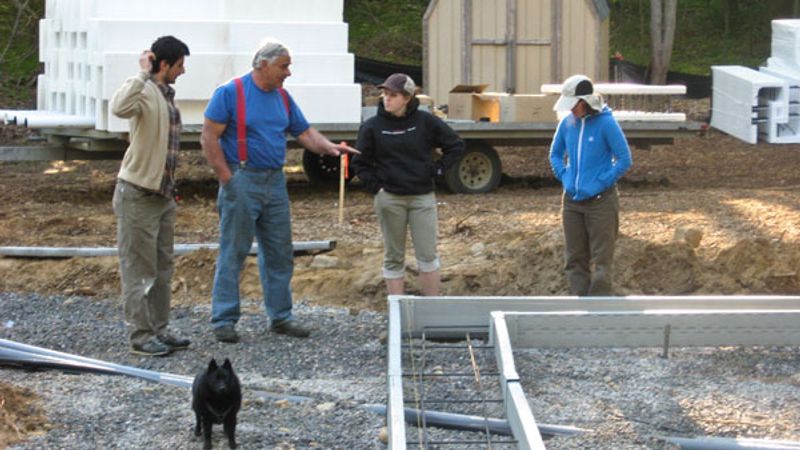

With sub-slab plumbing, the work is cast in stone, so to speak. Al not only helps regular folks build tight houses, he is their advocate when hiring and working with subcontractors. Here, he keeps the plumbers honest.

  6. Mike | | #6
    Al keeps a close watch on the plumbers
    I was just looking at this picture of Al supervising the plumbers "keeping them honest" and wondering if that is indeed the "King of Beers" in the foreground "keeping them company" as well?
