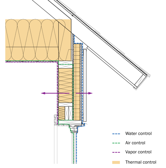

Learning the four control layers has been the backbone of building science basics for a couple decades now, but should we be thinking of adding a fifth?
I was recently part of a webinar where we discussed the basics of the four control layers: water, air, vapor, and thermal. These basic principles of building science were introduced to mainstream construction industry by Joseph Lstiburek a couple decades ago. One of the most influential articles on the topic can be found at Building Science Corporation’s website: BSI-001: The Perfect Wall.
In the webinar I was part of, the participants got into a discussion on whether the industry needs to add a control layer to the list. The organizer brought up the idea of adding acoustics as one of the control layers. Acoustics are important, addressing mostly occupant comfort. A second idea was also discussed: fire. This control layer would move away from occupant comfort and address property and personal risk. Let’s look at both these ideas, then you can make your opinion known in the comments.

    I think you're spot on with these being important variables, though, as always, there’s some nuance.
    Fire control absolutely deserves a spot on the standard list, although the performance of an assembly is a combination of the traditional rated control layer as well as the ignition resistance and fuel load on the exterior of that layer. E.g. an open gap wood rainscreen siding will provide a lot more stress an underlying control layer than if that same assembly had something that either did not provide fuel (fiber cement) or was more ignition resistant (minimally or unvented lap siding).
    Exterior will be the primary concern for most situations, but interior also comes into play with garages, Energy Storage Systems, and non SFH occupancies. Even for areas not currently prone to wildfire, climate change and shifting home insurance risk tolerance could make fire resistance essential to maintain coverage at a reasonable price.
    Acoustics, on the other hand, can be critical but is problematic to frame as a “control layer.” Like you noted, airtightness helps a lot, but beyond that, sound mitigation isn’t just about layering, it's about the interaction of mass, damping, and decoupling across the whole assembly. The “triple leaf effect” is a perfect example of how counterintuitive it can be https://www.soundproofingcompany.com/soundproofing_101/triple-leaf-effect
    Pests and radon are absolutely real issues too, but like acoustics they also stretch the concept of a control layer with the needs for deflection for termites and mechanical removal for radon. At a certain point, we might need a broader framework, something like “control elements” to capture elements that go beyond a "layer".

    I have batted around the 'Wind Control Layer' for a few years now as the Europeans often speak of this. This is good to consider if one is using an air permeable insulation that may be exposed to the exterior or an interior insulation that may suffer from convective airflow. Each could degrade the efficacy of the insulation and adding a 'Wind Control Layer' would address this.
    Another is the 'Structural Control Layer' This is often important to consider when tracing out the primary 4 control layers. Order of install operations often have to thread the needle between an air barrier and structure, for instance. Thinking about structure in tandem with the other control layers can be critical.
    Lastly, 'Water Shedding Layer' is one that I use occasionally. There is the 'Primary Bulk Water Control Layer' which is the ultimate line of defense for water ingress, which is typically the WRB or roof underlayment. I believe this should be the one that gets traced onto the plans. But the siding and roofing to the lions share of water protection and it may be useful to use the term 'water shedding layer' as a heuristic. The term 'Primary' can be confusing as it implies the 'first' layer that water sees. Maybe using the term 'Water Control Layer of Significance' is more descriptive, but ultimately its a mouthful.

    I'm a fan of listing out as many elements as possible when one is undertaking any sort of design work and seeing if all elements are being accounted for (sometimes there are compromises). You can then treat it like a tic list when reviewing the design or the final product. With this mentality, I would certainly go ahead and list out everything beyond the fundamental 4 control layers, including fire, sound, pests, UV/radiation degradation, wind, gravity, seismic, soil stability, light (good and bad), unwanted guests, spirits, etc. (internet filter to keep out the ridiculousness of this world?)
    This serves a different purpose than talking about the 4 fundamental control layers, which as the name implies, focus on actual "layers" and on continuity (though certain elements listed above certainly benefit from continuity). But controlling/protecting/managing (pick your verb) many elements, including the fundamental 4, really goes beyond simple layers, as others have mentioned in regards to fire management. There are always multiple elements at play.
    Even the fundamental 4 are somewhat ill served by discussing them as layers, since many times they are not one material or one plane. Conversely, one material can serve multiple purposes. We all know proper thermal control transcends the 'type' of insulation. The same is true of bulk water management (roof overhangs, proper overlaps, surrounding grade pitched away, etc.). It's never about just one isolated or monolithic thing. Is the final design accounting for ALL the elements that are thrown at it?
    The fundamental 4 layers are still a useful exercise and teaching tool. But in many ways I think that is its primary purpose: a teaching tool. There is no reason it is absolute or isolated from the other elements buildings must manage.
