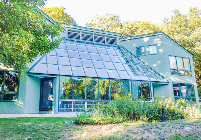

The Minergy House in Lexington, Mass. is a hybrid design whose central greenhouse is its solar engine. The 1980 house combines a double-envelope with direct solar gain and added thermal mass.
Image Credit: Marc Rosenbaum

I heard about the Minergy House being built in Lexington, Mass. (“Minergy” stood for MINimum enERGY). The 2,240-square-foot house, built in 1980, was a thoughtful hybrid. It featured a double-envelope design that also incorporated some direct-gain passive solar features with added thermal mass. Designed by architect Bill Mead for Doug Holmes and his family, it was emphatically not a simple box. Pueblo Bonito and Wright’s Solar Hemicycle House are cited as design precedents for this south-facing, chevron-shaped house. Doug, a chemical engineer, had significant design input on the performance side. I went to visit Doug, then in his 80s, and catch up on how the house has performed over the last 35 years.
The solar engine of the house is a greenhouse built by Mark Ward. It is a salvaged steel and cypress structure, glazed with double-insulated glass. It is cradled by symmetrical wings that reach out to the southeast and southwest. The center portion is double envelope, and the wings and the second floor are direct-gain passive solar. Doors on both levels of the house can be opened to admit solar heated air directly from the greenhouse.
Thermal mass is everywhere: in the dyed concrete floor slabs in the wings and second level; in the exposed concrete half walls in the first-level wings; in a salvaged timber frame floor structure with wood decking supporting the second floor; and in the multiple layers of drywall. Much of this mass doesn’t receive direct solar gain, but the area exposed to the solar heated air is large, and as it absorbs and releases heat, it stabilizes temperatures significantly.

What did we learn from the Minergy House and other houses like it? After 35 years, everything works! Nothing is automated or digitally controlled, so there have been no equipment failures. We’ve learned that using earth buffering to keep highly glazed buffer spaces from getting too cold is a good strategy. Sadly, in some cases, we’ve learned the hard way that exposing wood-framed buildings to bare earth can cause mold and decay. (I helped fix a decaying, moldy double-envelope house a few years ago.)
I think we’ve learned that we don’t need the double envelope; in fact, it was proposed that a retrofit for these houses could involve blowing the loop full of insulation. I think the most successful of the double- envelope houses were early superinsulated houses with the glazed buffer space not only providing some solar heating, but also reducing nighttime heat loss through the large south-facing glazed areas of the living space. That need has decreased with the highly-insulating glazing available to us today.
We’ve learned that we want very airtight envelopes, and that we need fresh air ventilation. Internal gains still help us heat our houses, but the source of these gains has shifted from incandescent lighting and inefficient refrigeration to the gaggle of electronic devices that fill our homes. And finally, I think we’ve learned that our knowledge is only extended by pioneers, like Doug and his family, who were willing to take risks.
