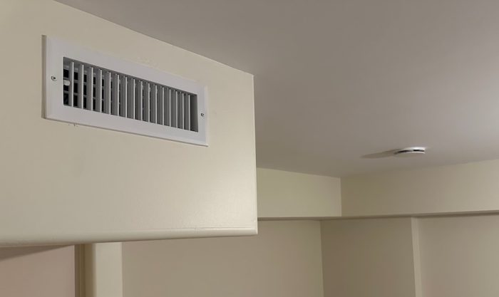

Go into a typical home and take a look at the supply outlets. Installers often like to use a limited number of sizes. The 6-in. by 10-in. supply register seems to be a favorite, at least here in the Atlanta area. The problem with many supply registers is that they’re too big. A larger register means lower velocity and less throw. And that can result in reduced comfort.

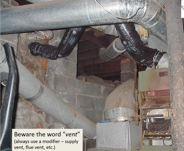

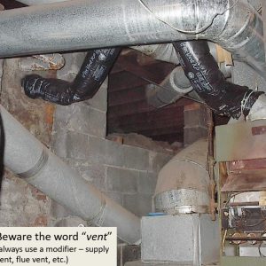

    A few things I have learned over the years:
    1. Never use the word "vent" without a modifier as it means different things to different people - supply vent, return vent, crawlspace vent, eave vent, ridge vent, flue vent.
    2. @bvillebound, don't use anything but mastic or mastic tape to seal ducts!
