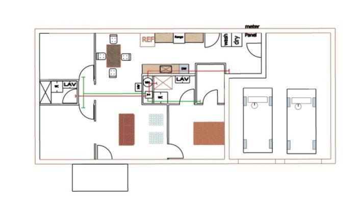

An example of this popped up in a recent Q&A post where GBA member “shawnbatt” tell us that he is designing a 1340-sq.-ft. ranch house in Climate Zone 5a. He estimates the heating load (the amount of energy required to condition the space) will be around 18kBU/hr. He wants to know if a centrally located ductless minisplit head can adequately provide his HVAC needs. If so, he’ll pair the minisplit with a fully ducted HRV for balanced ventilation, a partially ducted heat pump water heater (HPWH) for hot water, and even baseboard radiant heat in the bedrooms as a backup.
Shawn likes this plan because the house will not have a basement, and he won’t need to find ways to run more significant ductwork. He says that he’s generally OK with the idea of ducts…

    Not directly related to the topic, but this house plan desperately needs the input of an experienced designer or architect.

      Malcom, just curious, what do you see as the biggest problems of that floor plan?

        The circulation patterns, the relationship of the bedrooms to the common spaces, and that the living and dining room are sandwiched between service rooms and bedrooms so they don't have much exterior walls space connecting them to the outside. But more generally it feels like the space has been divided up with no theme nor governing idea as to what you are trying to achieve.
        Design is something that takes experience and many iterations to get good at. The first house I designed wasn't as well thought out as the second, and so forth. It's worth getting professional help - or starting from an existing plan you can make minor modifications to.

    In a cold climate ventilation air does not help even-out temperatures in a house heated by a ductless mini-split. This fallacy landed in our region with the arrival of Passive House and hasn't been fully shaken decades later. Even the best ERVs deliver air that is cooler than the house air. In a house that lacks direct heat delivery in some rooms this means the ERV is actively cooling off those spaces. In this small ranch that would have meant chilly bedrooms. As some have pointed out, the tolerance for bedrooms cooler than the rest of the house varies widely. As a designer the best approach is to create spaces where the conditions can be controlled to the occupants' liking. And a ductless mini-split ain't it.
    Panasonic has a hybrid solution to the issues raised by shawnbatt, although it's not evident it's suitable for a small house like this. The Panasonic Oasys system uses a utility room as a plenum, dumping fresh air, heated/cooled air, dehumidified air and filtered air into one space from which conditioned air is distributed to the rest of the house. It's a bonkers solution, but does solve a lot of problems associated with high performance homes, including allowing small ducts!
    Speaking of small ducts, have recently worked on a bunch of homes using the Rheia duct system. This approach uses us pressurized plenum and small diameter home run flex ducts to each space. The smallest ducts fit in a 3.5" cavity. Final performance testing next week, so can't yet fully endorse, but you can get a whole home duct design from the manufacturer and that's a far cry better than no duct design at all.
    As for the water heater, the latest crop of heat pump water heaters are blessedly quieter than those from just 5 years ago. Select a quiet model and duct both sides to a space where noise won't be a problem: mudroom, hallway, even the kitchen. But now we're talking even more ductwork, so best to just locate the water heater in one of those noise-tolerant spaces. The entry from the garage is the best candidate.
    Good luck, shawnbatt. Hard decisions ahead. It goes without saying, good design is always worth it.
