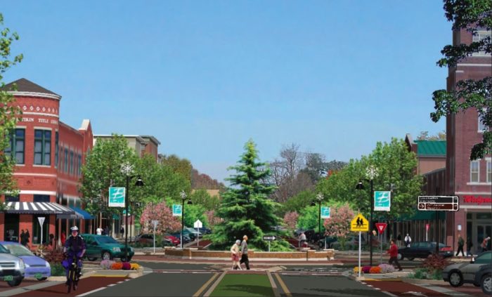

An artist's rendering of what Canal Street in Brattleboro could look like after a major redesign to make it more pedestrian friendly; see below for a current photo.
Image Credit: Brattleboro Active Living Workshop Report

Back in our home town of Brattleboro, a walkability audit was conducted last fall of one end of town — coincidentally, not far from where one of the recent fatalities occurred. The audit was part of a day-long workshop funded by the AARP Livable Communities Program. The Town of Brattleboro Planning Department brought in Dan Burden of the Walkable and Livable Communities Institute to examine how to make Brattleboro — and specifically the Canal Street end of town – more pedestrian friendly.
Included in the final report (download here – large file) are inspiring images that show how Canal Street could be dramatically redesigned to slow down traffic, provide for non-motorized (“active”) transportation, and improve pedestrian safety. All of these improvements would not only make Brattleboro a nicer place, but also save energy by making it more feasible for residents to leave their cars at home.
