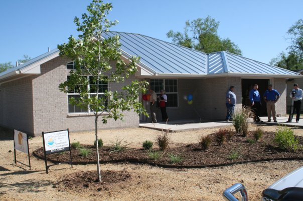

Ribbon cutting San Angelo officials celebrate the completion of the city’s first net-zero energy home. City officials noted that it is the first NZEH in the nation to receive U.S. Department of Housing and Urban Development funding.

That happens to be the case for a 1,332-sq.-ft. ranch-style home recently completed in the West Central Texas town of San Angelo. Showcased during a ribbon-cutting ceremony on Monday, the three-bedroom, two-bath house is billed as San Angelo’s first near-zero energy house and the first of its kind in the nation to receive funding through HUD’s Community Development Block Grant Program.
The HUD grant covered the cost of the property’s solar panels, metal roof, and gray-water recycling system, Robert Salas, assistant director of development services for the city, told the San Angelo Standard-Times. The balance on the $152,000 home is covered by a mortgage that will be serviced by the home’s very delighted owner, Caroline Bowman, who spent several years on the San Angelo Community Development Division’s waiting list for prospective homeowners.
