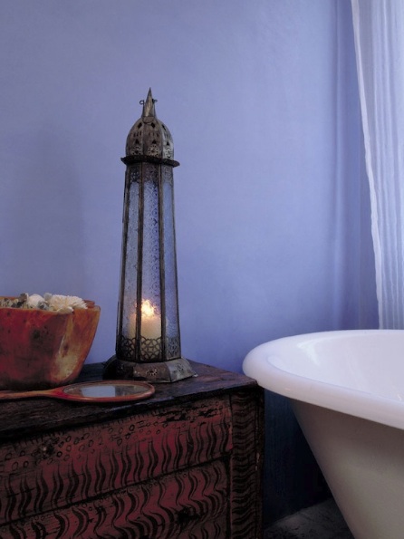

Smooth and breathable. American Clay’s Porcelina plaster, unsealed.
