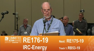

Robby Schwarz presenting and defending a code change proposal at the 2021 IECC code hearings.
Traditionally the code development process involves code hearings. Proposals can be made to modify any section of code or can be used to develop completely new sections. All proposals must include a reason statement as well as a cost statement. After a proponent develops a code change proposal, their best chance for success in getting it approved is to attend the code hearings in person, introducing the proposal and then speaking directly to its merits. Code hearings generally take place over the course of 10 to 14 days, sometimes lasting 16 hours, depending on how fast the process of hearing each proposal takes.
The committee action hearing kicks it off
The first hearing is called the committee action hearing. This is where the proponent of a proposal has 2 minutes to speak to the merits…
