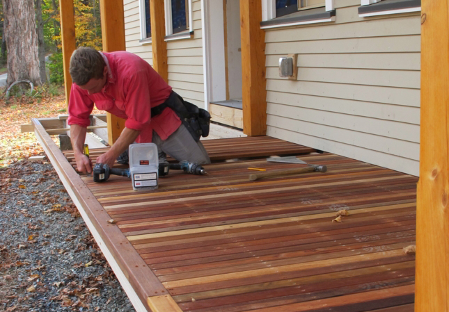

A dump truck unloads tropical hardwood shipping material at the Viridian warehouse. Workers sort and band wood for further processing into flooring and other products. Workers install decking on what will be our screen porch on the back of the house. A decking detail on our front porch. To install the densest of the Viridian Jakarta Market Blend decking, it's necessary to pre-drill with holes the full diameter of the screws.
We’re moving along with some of the wrap-up work on our house in Dummerston. One of those projects is installing the porch decking on both the front and rear porches and a handicapped ramp up from the garage to the back porch. (Yes, we plan to live there for a long time!)

Because Viridian’s tropical woods are reclaimed rather than being cut from forests, the species vary widely and typically aren’t even known. We ordered a mix of wood known as Jakarta Market Blend – Dark Sort that is comprised of probably at least a dozen actual species. Some are very dark, almost black; others are a deep red; some have beautiful figured grain. The weight also varies greatly, with some having specific gravity that is significantly greater than that of water — meaning that that wood doesn’t float.
The great density of these tropical hardwoods also results in tremendous hardness and wear properties. With flooring, hardness is typically measured using the Janca Scale. The Jakarta Market Blend – Dark Sort flooring we got has a hardness ranging from 1100 to 3500, which makes it suitable for high-traffic commercial applications. By comparison, eastern white pine has a hardness of 380, hemlock 500, Douglas fir 660, cherry 995, teak 1155, red oak 1290, and sugar maple 1450.
As we were selecting from the batch of wood received from Viridian, I chose the heavier pieces for the porch flooring — so I suspect most pieces have a hardness well over 2000. The dimensions of the decking are 2 1/2 inches x 5/8 inch, in random lengths up to 6 feet 6 inches.

Don’t even think about installing Viridian Jakarta Market Blend flooring without pre-drilling. Eli Gould’s crew started out drilling as they might for standard decking — with slightly undersized holes, but they were breaking off the stainless steel decking screws right and left! This stuff is hard!
We installed ours on framing made of TimberSIL, a totally nontoxic pressure-treated lumber. With TimberSIL, sodium silicate is infused into the wood under pressure, and the wood his then heated in a kiln, which melts the sodium silicate into an amorphous glass. This glass surrounds the wood cells, protecting it from decay and insects and well as imparting fire-resistance.
